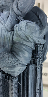

Is it just me or does it no longer retract after printing support and starts to print perimeter or next solid layer?

It's a bug, there's no retraction between layers even if you force it with the checkbox. It'll ooze filament across your print no matter what.

hi, you can simply solve that by turning on FORCE RETRACTION BETWEEN LAYERS on advanced tab

afshin wrote: ↑Mon Nov 12, 2018 11:19 am hi, you can simply solve that by turning on FORCE RETRACTION BETWEEN LAYERS on advanced tab
That wouldn't solve anything as my problems aren't between layers, and enabling that introduces other problems I don't want.
