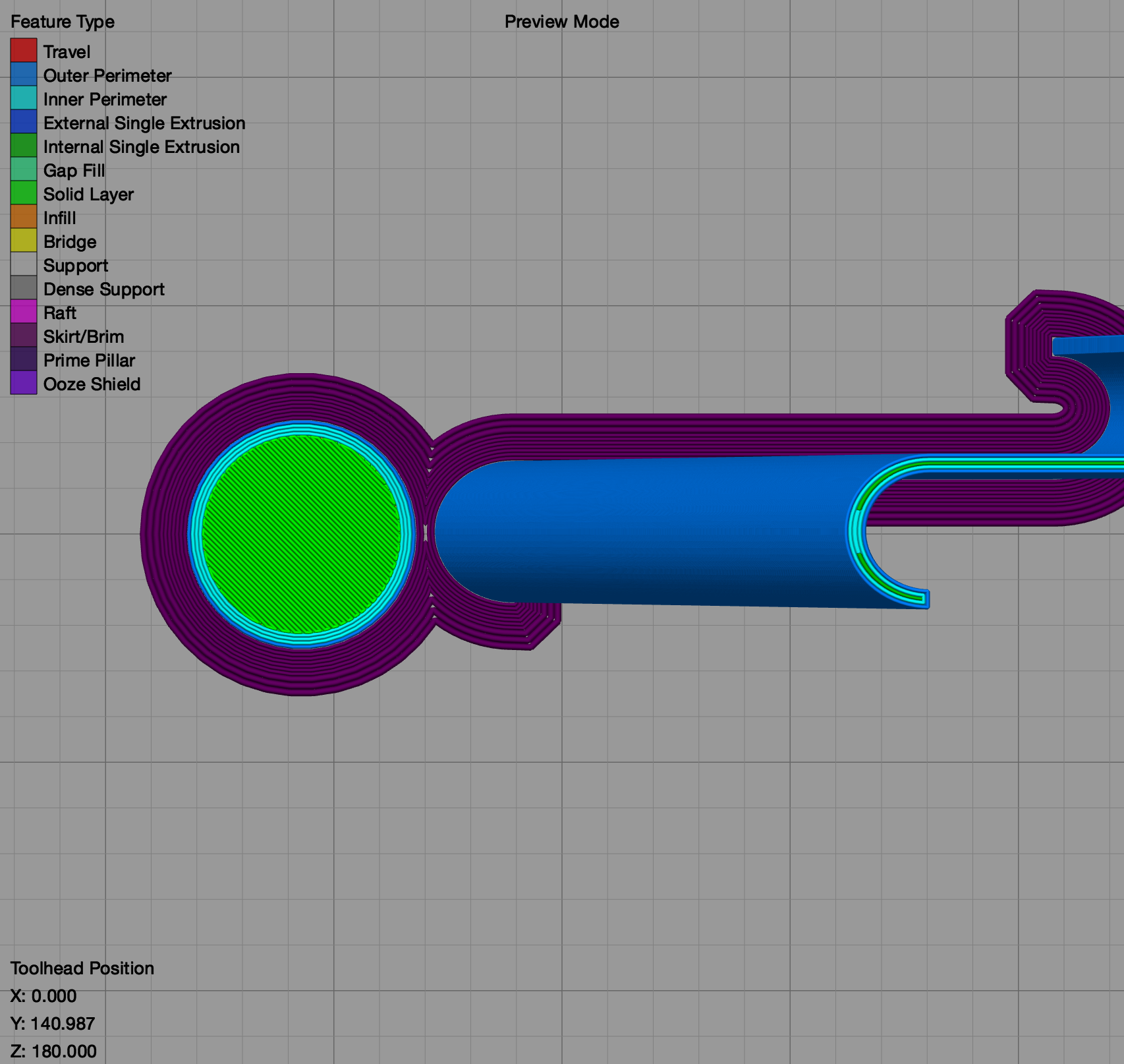

Re: V4.1 brim "around" models not "between"
I’m happy to state that this issue where the skirt/brim would not connect when objects were closer together should be resolved now in the latest 4.1.1 release. Our team successfully tested factory files from threads mentioning this issue. In version 4.1.1 the skirt will fill the gap between the two models similar to how it would in version 4.0.1. This was just one of many improvements to the software. All of which are detailed on our Release Notes page.
Brim tested in 4.1.1
