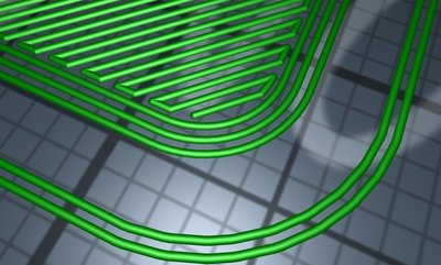

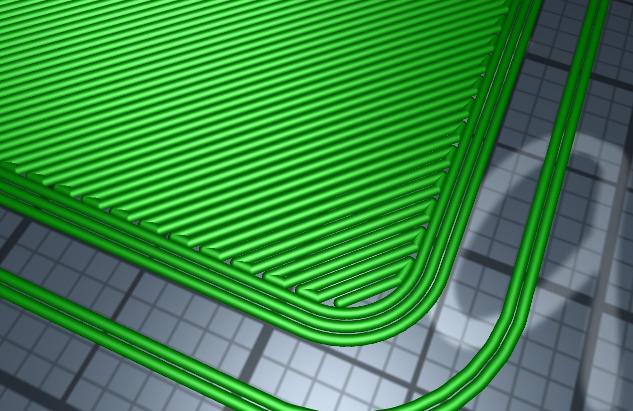

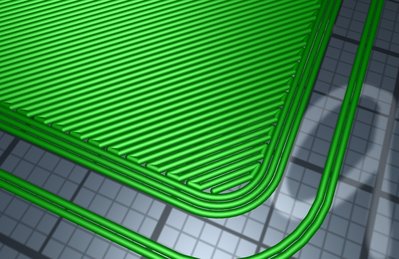

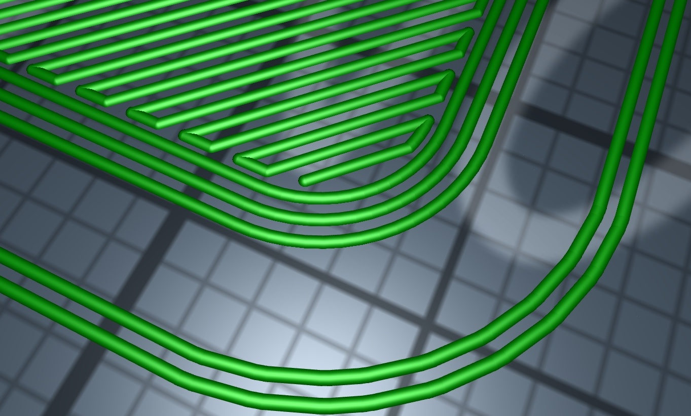

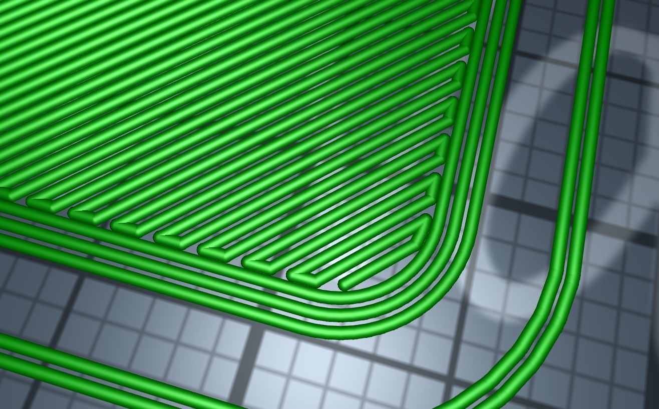

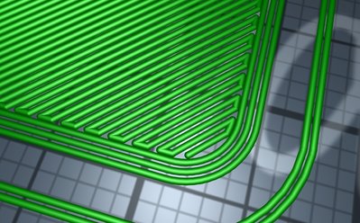

I have an issue with the layer fill, which seems depends a lot on layer hight.
I would expect not too much difference if I only change the layer hight, but there is a huge difference. Additionally, I need to increase a lot the extrusion multiplier to have a satisfying fill of the layers.
Attached pictures show the generated G-code itself to exclude any printer issue..., rendered with another slicer, which represents more realistically the phisical dimensions and distribution of the extruded material.
The real printed objects show exactly the same symptoms.
The issue is not only valid for the first layer, but to the case for the first layer.
You can also recognize the problem on gep in the skirt.
Case1: Layer hight set to 0.1mm
Case 2: Layer hight set to 0.2mm with exactly the same settings for the rest as Case1
Case 3: Layer hight set to 0.2mm with 140% extrusion multiplier results acceptable fill of the layers
