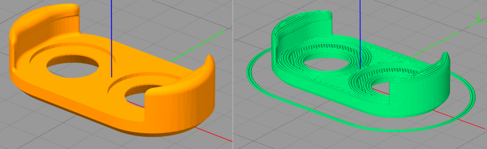

My model was fine:

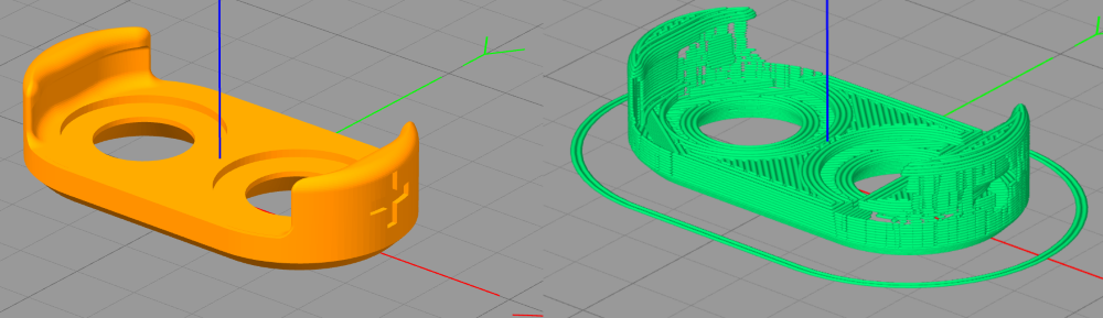

edited it slightly, a little narrower, a little shorter, and now its impossible to print
the CAD is solidworks2016,
I had the issue with s3D 3.xx (cant remember the numbers), upgraded to the latest, still the same issue.
Went back to solidworks and tried all sorts of settings on the resolution of the stl, no progress there (S3D exactly the same)
Ran all the repair stuff that would run in s3d, got nowhere with that.
So it looks like i hit on some sort of dimensions in my model that S3d just fails to slice correctly.
Whats with that?

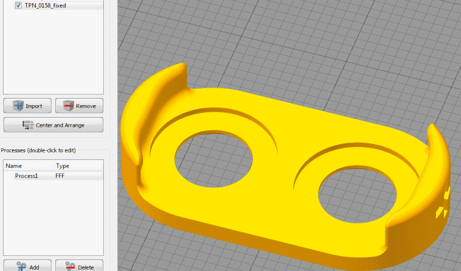

Your model has some issues what S3D can't repair while slicing.
NETFABB has fixed it, fixed-file is attached.

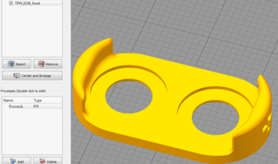

Thanks for posting that fixed file.
However although this STL opens and looks right in solidworks, it refuses to load in my version of Simplify3D, which I dont understand.

Well, file, import doesnt work
but opening it from the file explorer ans selecting S3D did work....
I then saved it as ASCii rather than binary and it behaves as normal and opens from file,import then.
