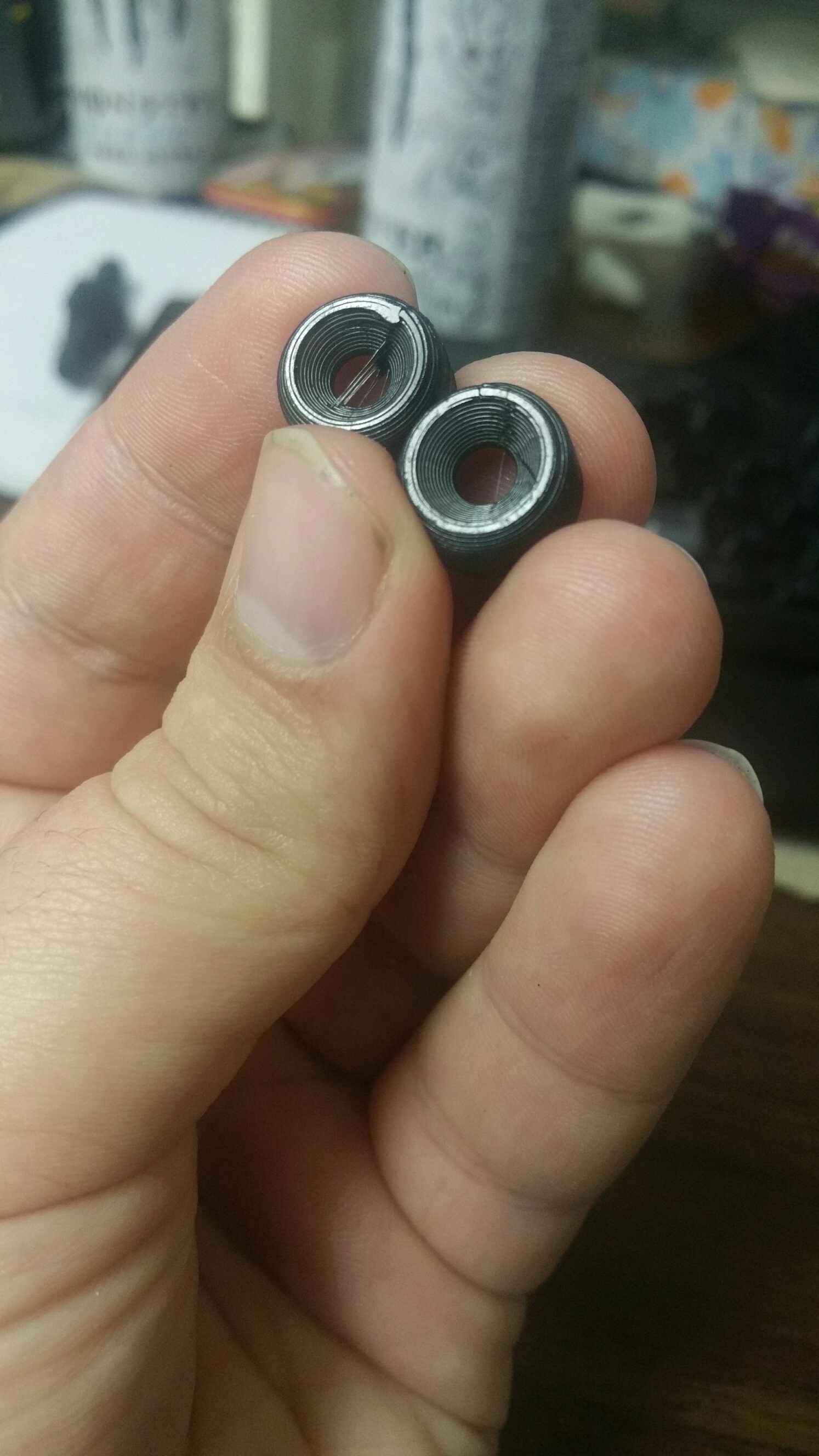

I'm also having issues with first layer. With 4.1 I hear filament grinding when it "retracts" between perimeter and infill on the first layer, and see it squirt out extra instead of retracting. It randomly does the same on subsequent layers. It's also pretty notably underfilling the first layer regardless of 1st layer settings (unless it's just thin features), unless I bump up the perimeter overlap to the point where I get bad top layers.
I generated gcode for the exact same part with the exact same settings in 4.0.1 with zero issues, quiet as the machine could possibly be. Good faces all around, no blobs or real cleanup needed. The grinding seems to be related to thin feature infill. Part shown is an stl export from solidworks, there aren't any bad faces or weird geometry to contend with. Just a cylinder that tapers to a flat face with a fillet on the outside, chamfer on the inside
4.0.1 on the right
