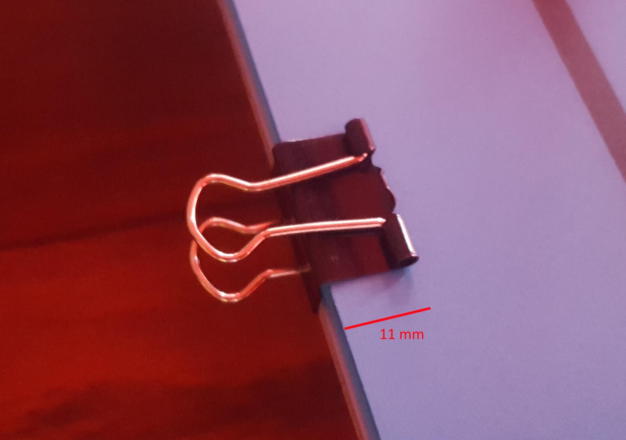

The Alfawise U20 bed measures exactly 311 x 311 mm but there are 4 pliers to attach the bed to the heating bed.
I measured the pliers and it is 11 mm wide :
So in reality the bed is only 311 - 2 x 11 = 289 mm long ( Y Max ) if you put the pliers int the front/back side ...
In the profile it should be 289 mm wide or you can hit the plier with the extruder if it is at zero on Z.
It happened to me. I was levelling and then right after i started a print.
The extruder went straight to X=0 and Y=0 and hit the plier that moved off the bed ...
