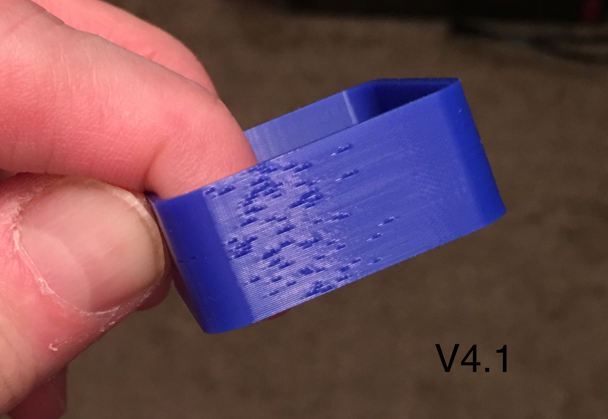

I was printing a peg-hole torture test and noticed my printer was stopping for what seemed like a long time at repeatable points. It turns out S3D was performing extremely slow retracts which made it seem like the printer was paused.
For example, S3D generated a bunch of E-1 F3 slow retracts at the edge retracts in the following picture:
Attached is the stl and the fff.
Here's the gcode where the super slow retracts occur (notice the bunch of E-1.0000 F3):
