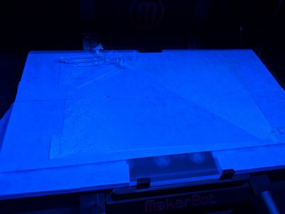

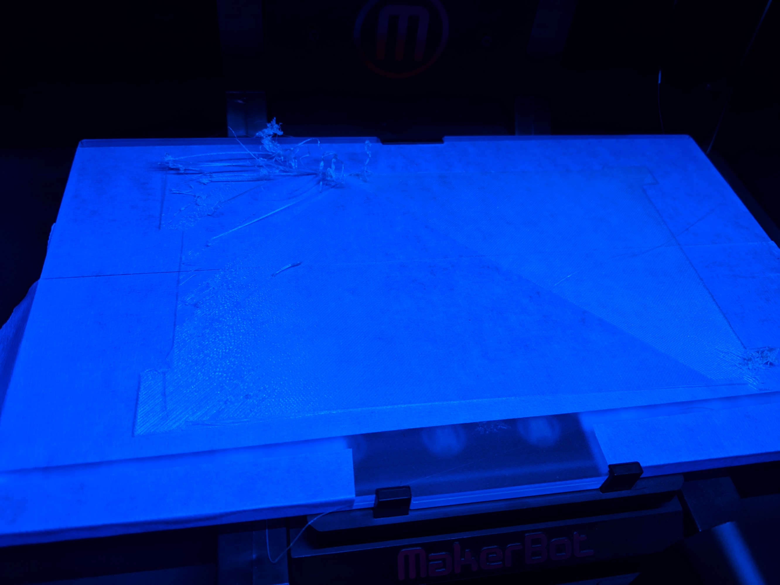

Attached image. It looks like the bed is uneven and/or needs to be releveled but with out touching it i'm printing the same object using Maker Desktop in the same way and that same base layer is far better.
I've done a lot of printing so i am used to leveling. May be for Simlify3d i need to make it really tight?
I have a glass plate i can try. Also I suppose i could try a raft. may be glass plate plus raft will do it.
I think there once was a time where all of my prints (done just like this) were Simplify3d. I dont know what happened, if i started to print larger prints or what.
Could my settings have gotten messed up? What would i do to sure-fire reset all of my Replicator 2 settings to what the company would have me use? Is there a way to nuke it all and get a fresh start on that?

As I explained in an earlier thread, you may need to adjust your first layer settings to get the same "squish" effect you had probably setup previously in versions prior to 4.1.
solution proposed in the earlier thread: viewtopic.php?f=9&t=6876#p46986
