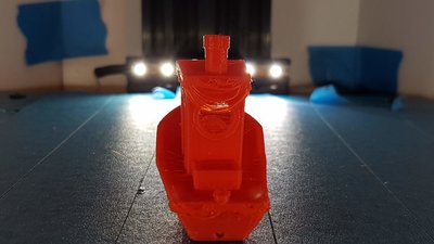

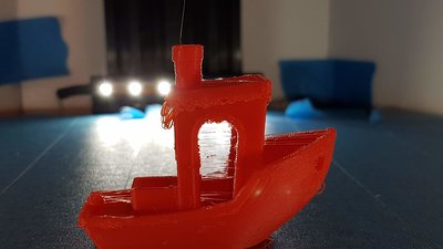

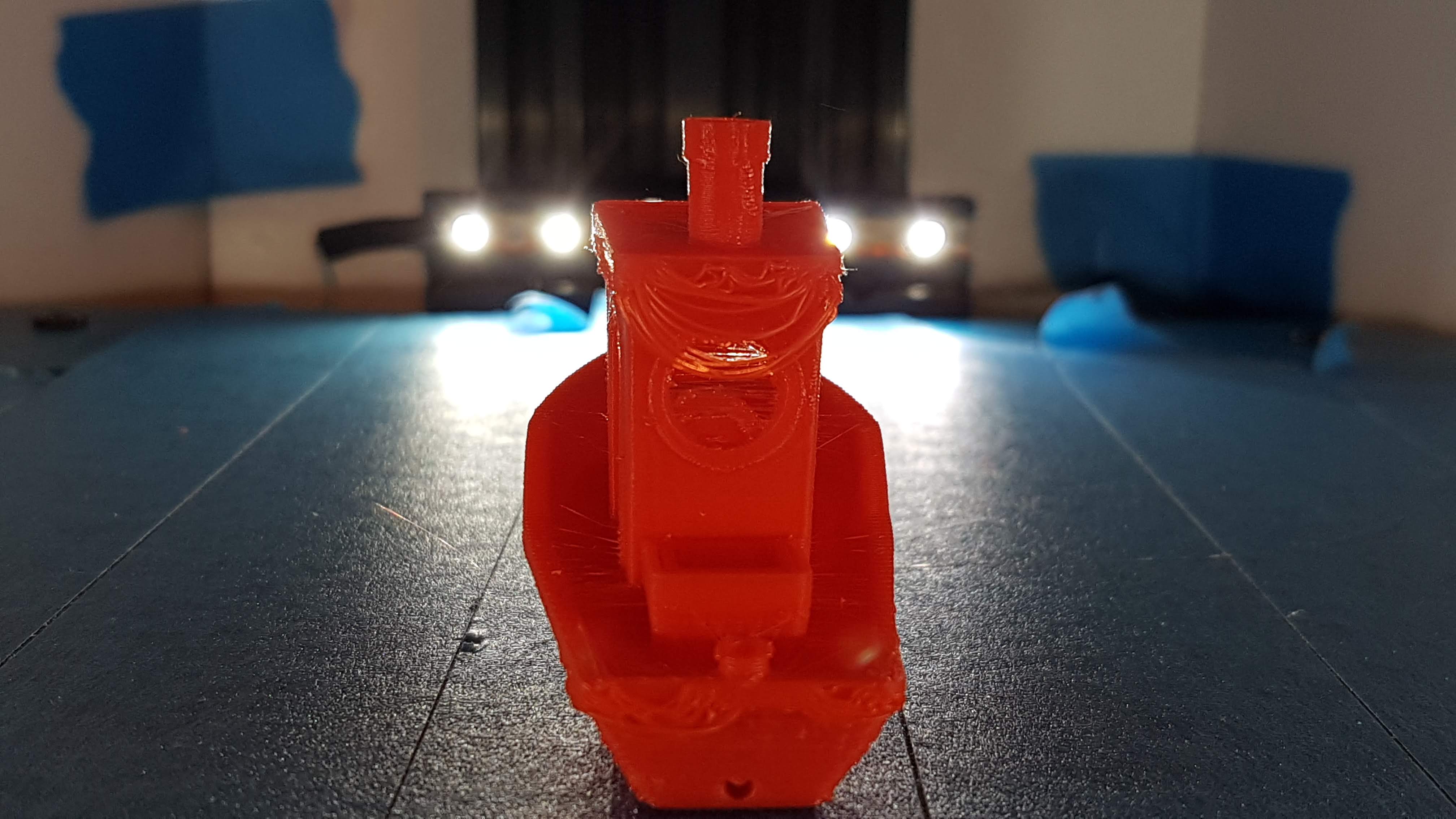

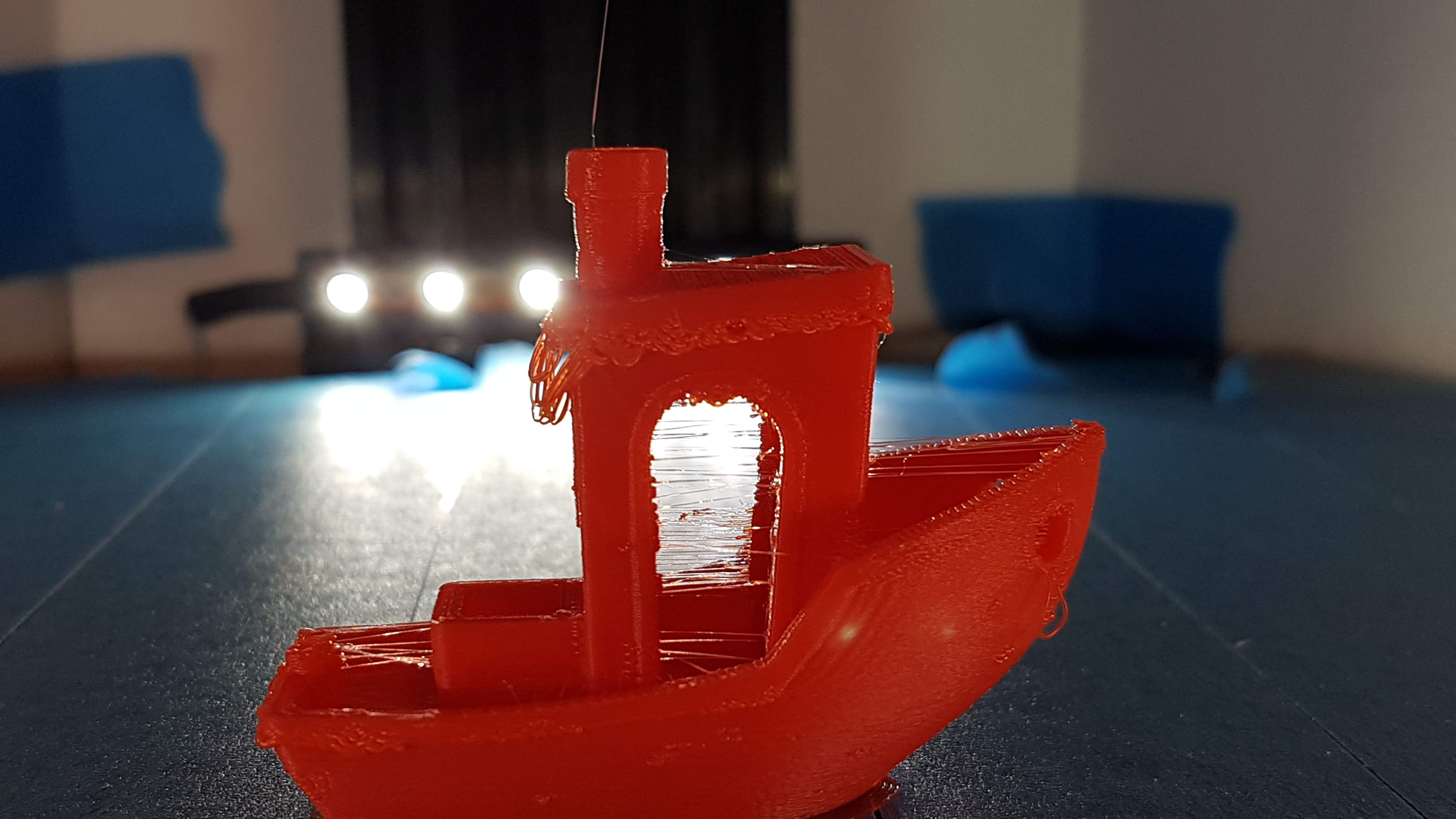

Can you tell me what parameter I have to play to clear this problem?
I see that I have a problem of withdrawal but on the top and on the side of the Benchy I think it is a bridging problem, what do you think?

Not a big one, but I can see some of that happening if your Outline Direction is Outside-In.
Also stringing, so see here...
https://www.simplify3d.com/support/prin ... -or-oozing.

Just had a quick look into your settings and couldnt´t find anything so far off.
Basically it should work, although not perfect.
70mm/sec may be somewhat to fast and depending on the brand of PLA 220° may be a little bit hot.
For the stringing you will have to play with retraction and wipe settings.
I take it your printer has a bowden extruder? Otherwise the retract would be to high.
My gut says (depending on the pictures) you are quite overextruding.
One other thing is, in your start script there is a "pressure advance" activated which I take being
something like lin advance for the prusa styles. Using this you normaly need coast and wipe unchecked...
