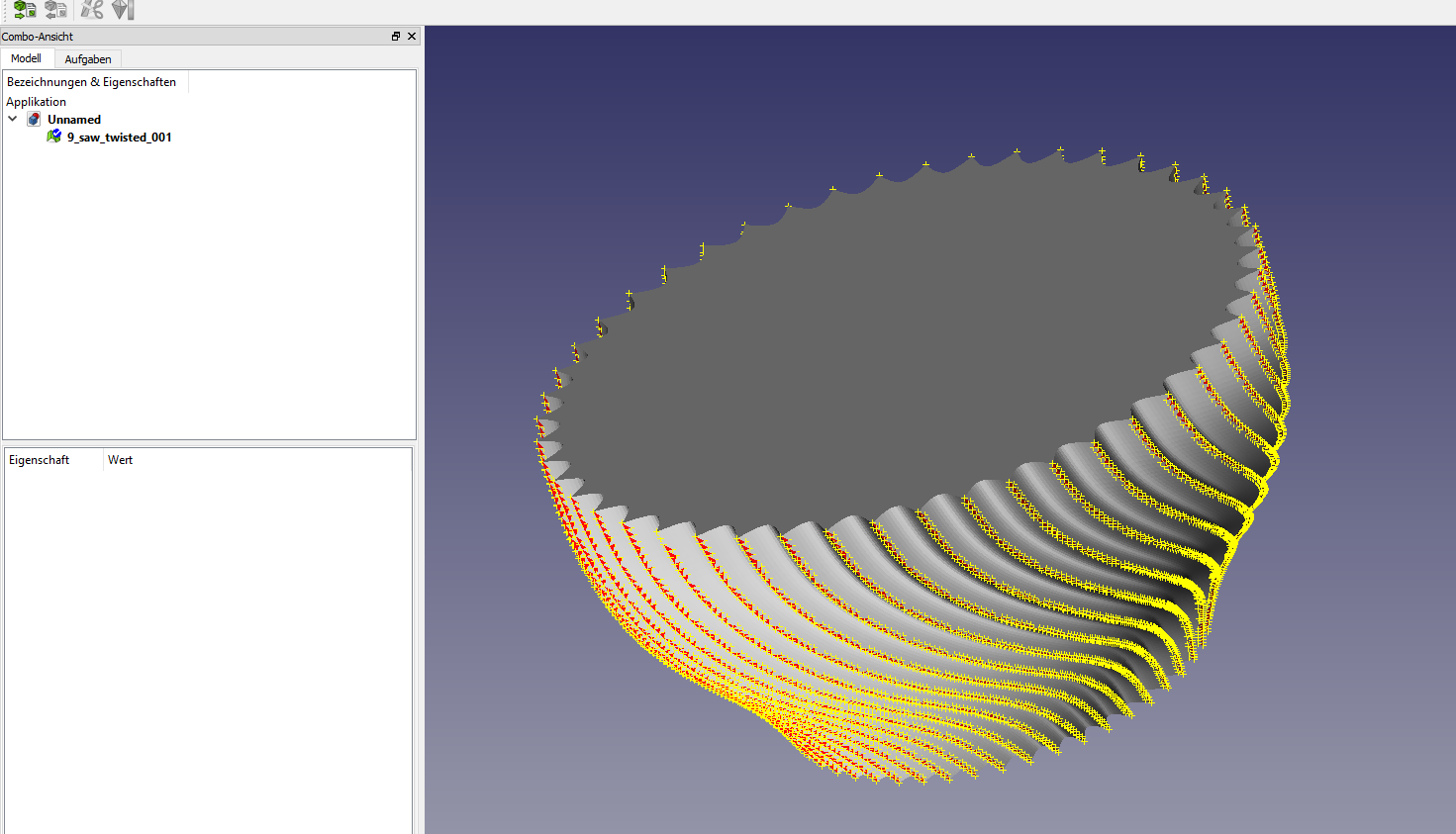

I take it that this is (just to be sure) the vase # 9 of all those vases provided in the above given download link.
Checking the mesh wit FreeCad it shows that that mesh has lots of defects.
See picture # 1
Depending on extrusion widths (with 0,4mm it does not happen at all) I could reproduce the failure with
the original downloaded file.
See picture # 2
Running it through Netfab online repair I got no error-report but can not remember having gotten one any time.

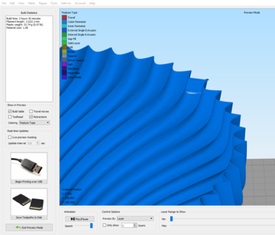

Downloaded the Netfabb-processed one and sliced it with exactly the same settings.
Voila! See picture # 3
I would like to see the answer from S3D service where they presumably admit this being a bug.
No question, they can do someting about it, say letting the software handle minor mesh defects differently, which is a good thing.

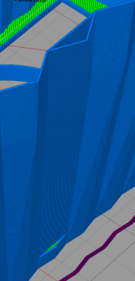

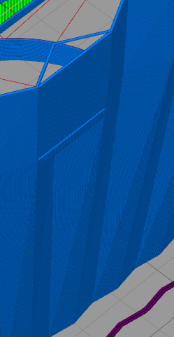

This is indeed a bug in vase mode. I get it all the time in Simplify 4.1.1. I have found that playing with the start point will often cause it to go away, but sometimes nothing I do will fix it. Here is an example:
with the start point at 200,300, I get:
with the start point at 100,100 I get this in a completely different place:
and with random start point selected, I get this:
This stl file is perfect. In non-vase mode, it slices correctly. I've run it though different checkers with no problem. No doubt it is a bug in Simplify3d 4.1.1
