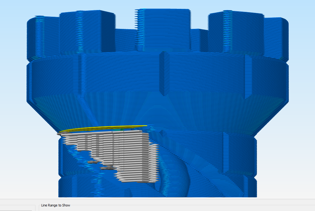

Printing the supports every layer everything is just fine.
Combining supports every 2nd layer the dense supports are missing.
Certainly, the supports then are just printed every 2nd layer and every other one is skipped and if being a dense support just missing.
And still, in my understanding the combining of support layers is for saving time where quality is of no concern.
But where there are certain layers (dense at bottom and top are determined) they should be printed,
no matter what settings for the raw support structure in between.
Just an idea of mine, I can handle that behaviour, if neccessary with multiple processes.
Not sure if this is only in 4.1.1 (which by the way now gives quite pretty prints )
but I rather believe this was already in the previous version.

The pitch of dense support itself is strong when printing just every layer.
The pitch of dense support printed "only" all 2nd layer must have a double ratio, so it will be mostly not possible to print it in this way. I guess!

Trying to upload my factory files I unfortunatelly get an error message the file being to big! (6mb)
No matter what, I would not even call this being a bug.
S3D makes exactly what is determined and printing only every second layer as set in the profile.
But doing so to save time with the "normal" support structure,
it would be helpful to ignore that setting for the dense supports
which are separately determined in layer density/quantity and seperation layers.
