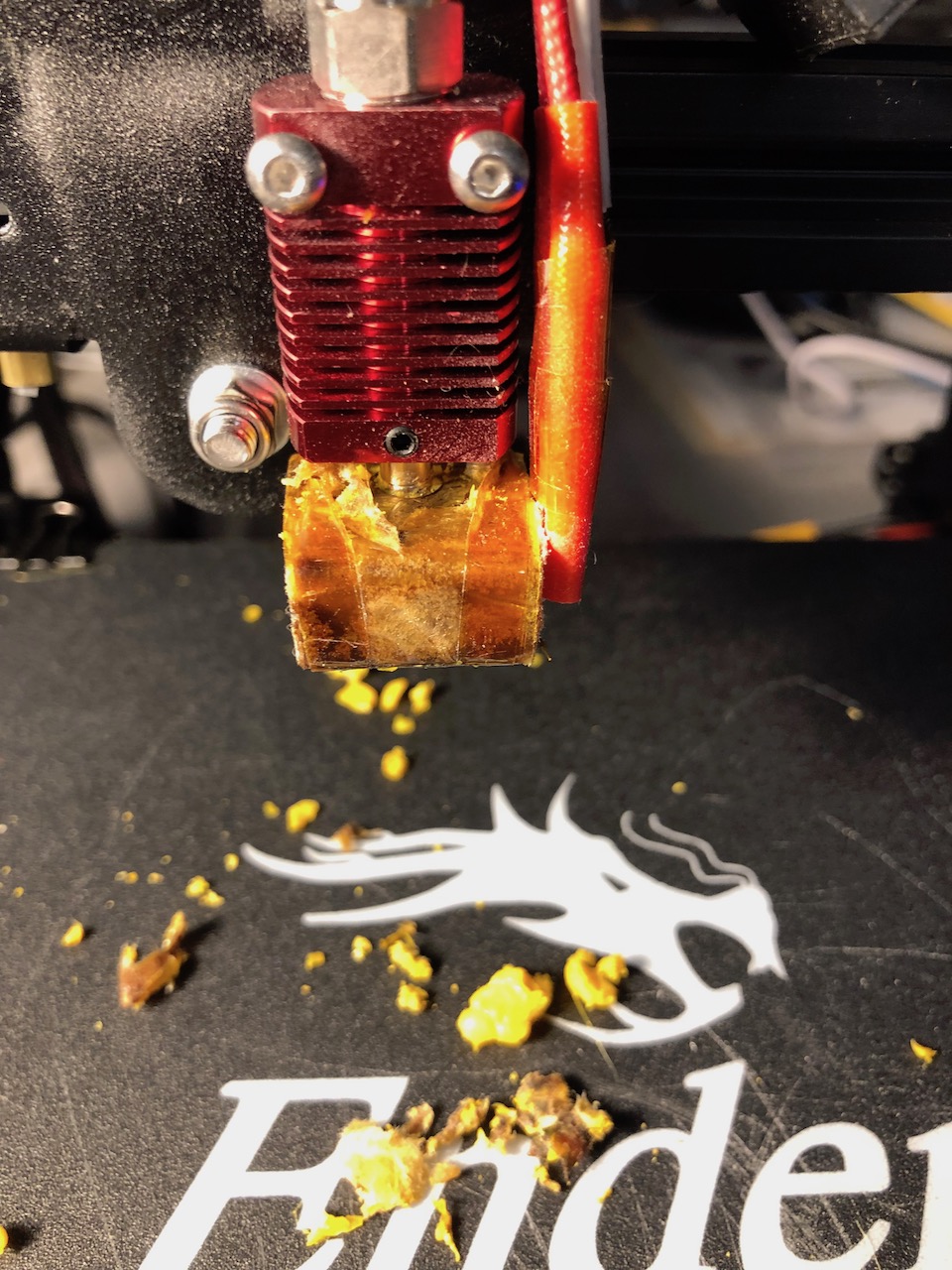

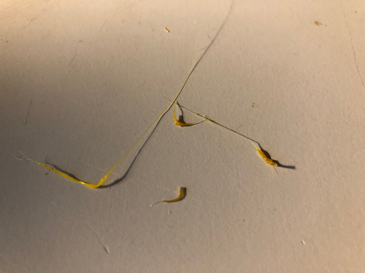

Good morning (o;
I just installed a new roll of PLA to my Ender-3 printer...
It starts printing very nicely....but from time to time a clog comes out of the nozzle like the attached picture...
It's not that it is stringing all the time.....and some PLA material gets collected on the it seems...
Do I need to reduce the "Extrusion Multiplier" ?

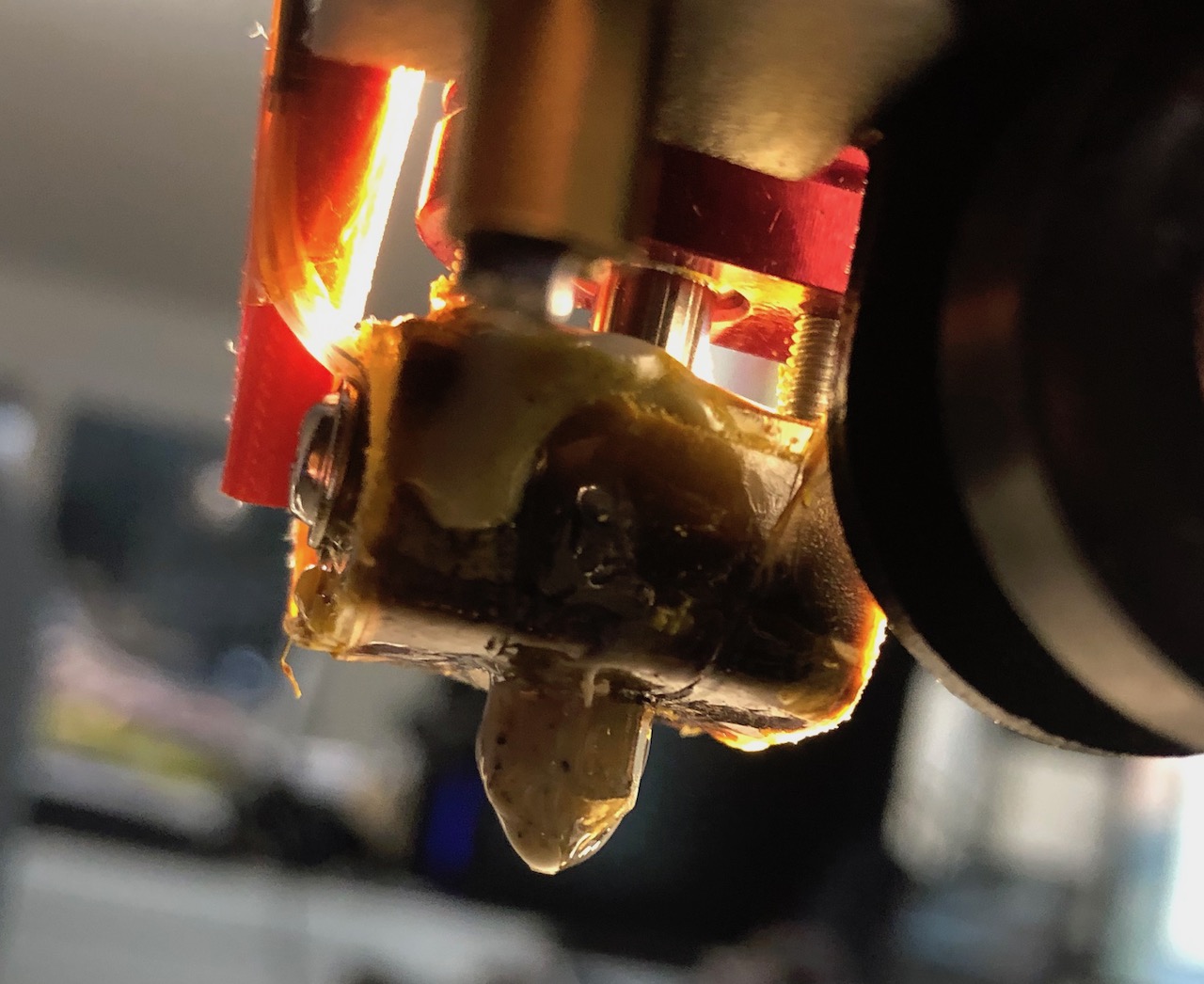

Seems I have found the source.....before I ran some tests with Wood filled PLA....which caused the nozzle to totally clog up....
I cleaned out the heater element and the nozzle....but seems I could not fit it tightly back to the heater....
Between the heater and the heatsink it was filled with PLA....yellow and dark....so somehow the PLA escaped not only from the bottom of the nozzle.
The print itself was perfect except for all the dirty PLA thrown onto the surface....
Just dunno where it actually escaped and got pulled up between heating element and heatsink...

Well I hope PLA was running out of the nozzle screw....can't imagine where else...
What puzzles me is the fact how the excess PLA moved all the way up to the heatsink....

Replaced the nozzle now....had one spare...and the ones I ordered where M6 instead of MK10 (o;
Looks somehow the PLA runs out above the heater......just dunno why...never touched the upper part....and the nozzle I screwed in very tight.

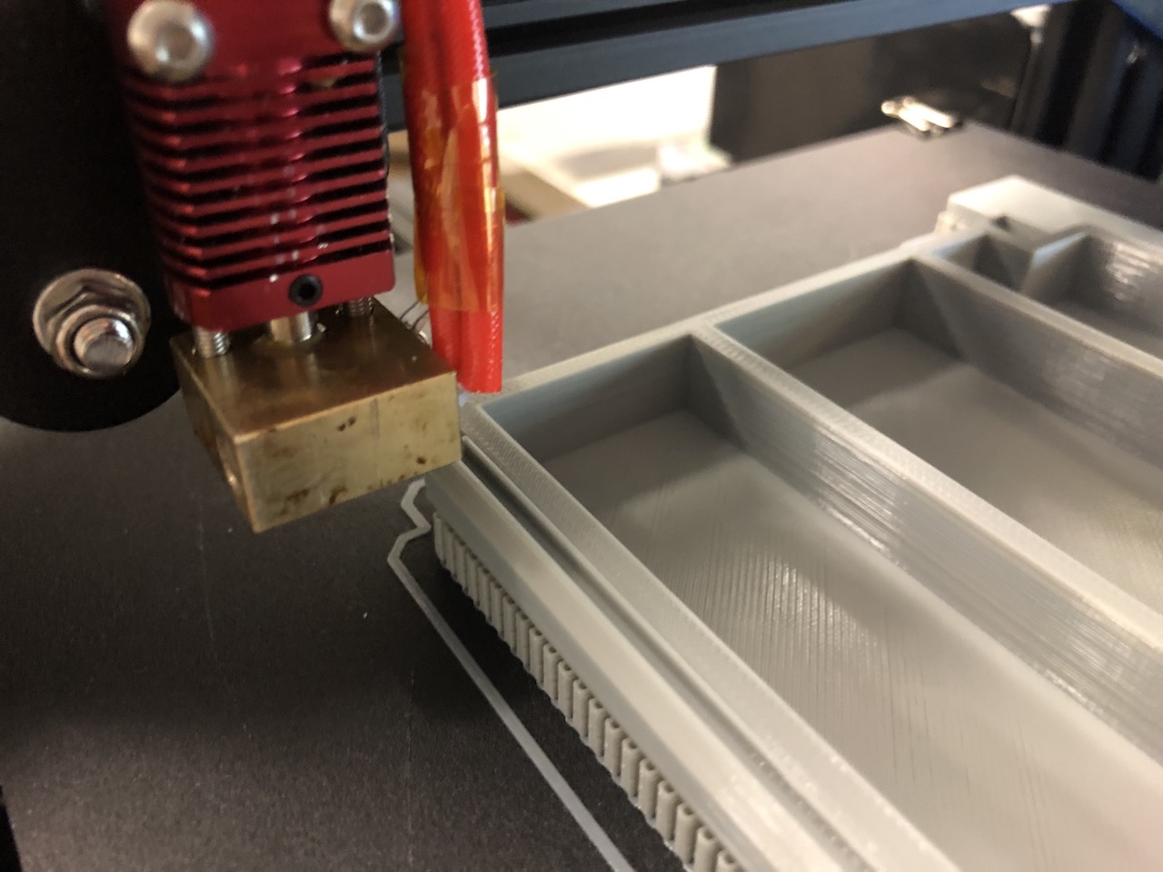

Took now the print head apart....removed all PLA.....cut off a little of the PTFE tube end...and put everything back together....
After a longer test print (7 hours) the print head still looks clean ;-)
So back to normal :-)
