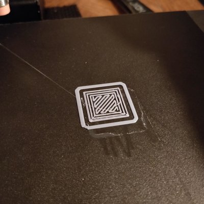

I've read through the entire print troubleshooting guide and shifting the recommended settings don't appear to fix my issue. My first layer is extremely spread out, except for the skirt. I did change to a BuildTak printing surface recently, but the skirt printing fine leads me to believe it's not a hardware issue.
Here's the first layer. You can see there's a lot of space between the lines, but the skirt appears to be normal.

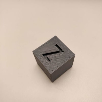

Here's a completed print (I realize now this is a slightly different print, but I don't have a picture of the first layer of this one)

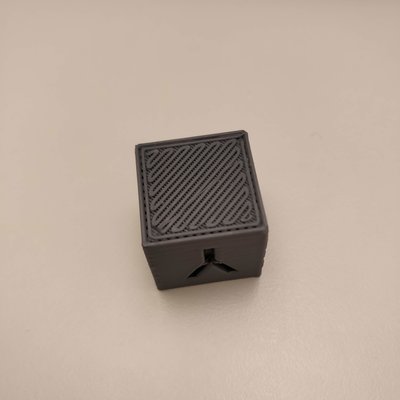

And here's the top layer. Maybe a touch of underextrusion, but not nearly enough to cause the first layer.

If your first layer height is set to a value below 100% and you're using 4.1.1, the amount of plastic pushed through the nozzle will be less than it was in prior releases. I'd recommend setting the first layer height to 100% and then using the Global G-Code Offsets in the G-Code tab to lessen the distance between nozzle and build platform. This will mimic the slight squish you would see in earlier releases of Simplify3D.

Thanks, I guess that's it. Any chance of adding something like "First layer extrusion multiplier" in a future version? I'm hesitant to move the nozzle too much closer given it's already adhering pretty well, it might make it even more difficult to get the part off.
Re: First layer issues
I would make small adjustments with the Global-Z setting on the GCode tab.
Adjusting the offset value in a negative direction will have the effect of lowering the nozzle very slightly. You should be able to get the gaps between the extrusions on the bottom to close up to form a neater finish.
The good thing about using this method is that its easily reversible....and once set for one setting, it's transportable to other setting profiles.

I suspect youre too high over the bed for your first layer. Try resetting your z zero point to .05 or .10 lower than it is now.
