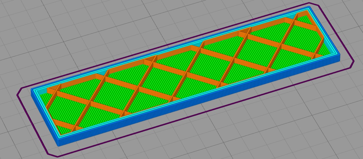

i think that the single extrusion line infill is pointless , even with 80% infill it does not add much to parts structural properties .
i wish i could choose infill width by number of layers , same as done for outer perimeters .
for example this is 3 layer wide honeycomb
i want to be able to make a 5 or 10 layer wide honeycomb infill , or 10 layer wide rectilinear infill .
as of now i can only make single layer wide rectilinear , which is very weak .

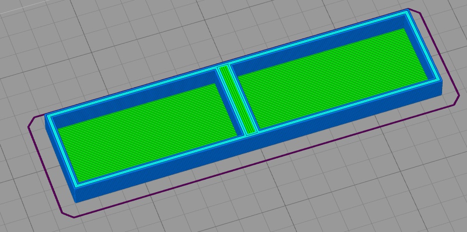

for you maybe .
it depends what you print .
for me it will be a gain for structural use .
for example this infill has no structural use for me
if i know i'll have a high load in the middle of the part , i prefer a thick line infill like this
in this case for example the choice would be around 5% infill , 6 line thick infill ,90deg angle .
so (example again) if i choose 10% instead of 5 there would be 2 90deg , 6 line wide lines like that .
also adding an offset option , so in the example i could move the infill line right or left . this can be useful if there is a hole in the part and you want the thick infill to pass where the hole is .
