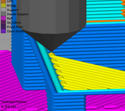

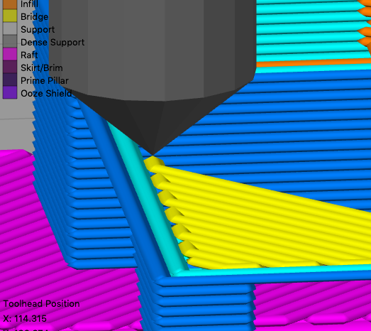

I couldn't find outline overlap settings specificaly for bridges only while printing well known stress test cube. Cura 3.6 can handle that very nicely but I'm having a problem with bridges because they don't stick to outline enough in S3D 4.1.1.
S3D 4.1.1.:

The only workaround I've found was to use Variable Setting Wizard and set Infill Outline Overlap for part with bridges. But it's really not a smooth way to do it. So I think a specific settings would be helpful.
BTW As a 3D beginner printing the stress test cube with falling bridges this was the first option I was trying to find. So I was very surprised it didn't exist.

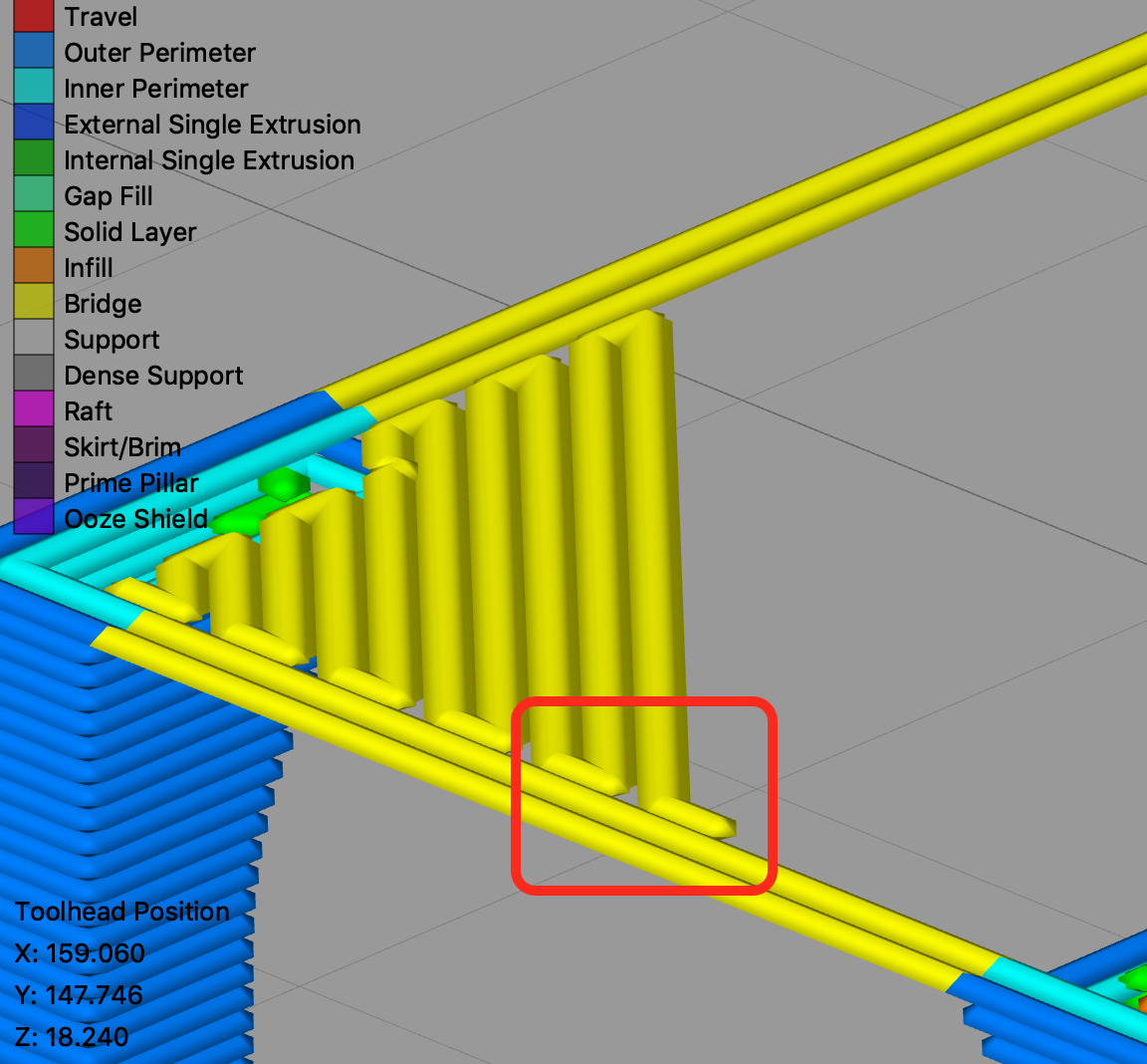

I'm particulary interested in area where outline is bridge as well. Just like in my previous screenshot.
Re: Outline overlap for bridges
You can add more bridging inflation distance and the bridging will overlap the infill areas as well. Also if you need the perimeters to have bridging settings applied, you can check the box to have the settings applied to them.

S3D-Jake wrote: You can add more bridging inflation distance and the bridging will overlap the infill areas as well.
Yes, I was playing with that parameter but unfortunately it didn't help with this area:
S3D-Jake wrote: Also if you need the perimeters to have bridging settings applied, you can check the box to have the settings applied to them.
Ah. I missed that settings. Nice (although I would expect it's enabled by default).
I'm leveraging stratched bridges to avoid sagging using bridge underextrusion but then bridges don't bond properly to outline. I might play with bridging speed as well to avoid underextrustion. But I really think an extra outline overlap for bridges will be helpful.
