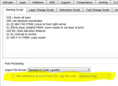

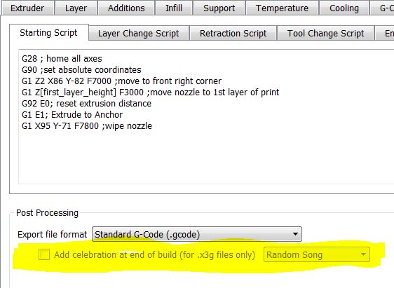

I was seeing the same result of the print has finished but S3D was still sending G-Codes so I examined the verbose log at the end of the print and discovered this was caused by a setting in the scripts tab. If you are NOT using the .X3G format then you need to turn off (uncheck) the celebration option as it still sends the celebration codes to the printer hence why the print has stopped but S3D is still sending. Below is a pic of the setting that needs to be unchecked.
