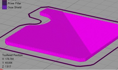

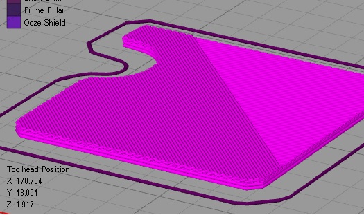

(a)Raft Top : Z=1.917

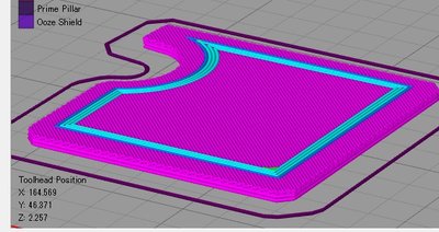

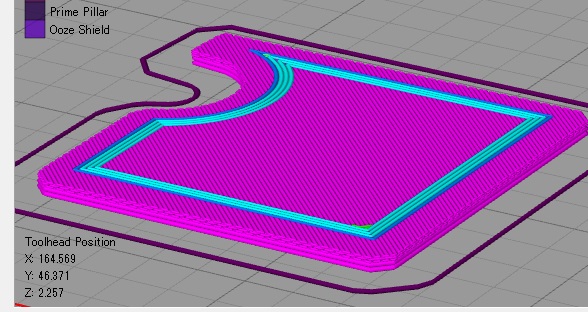

(b)First Layer : Z=2.257
(b) - (a) = 0.34mm = 0.2mm(PrimaryLayerHeight) + 0.14mm(SeparationDistance)
The height of the first layer becomes large only the distance of SeparationDistance.
Therefore, the whole height also becomes high. ( +0.14mm)
I think that it will be what is depended on a machine if there is an error beyond this.
