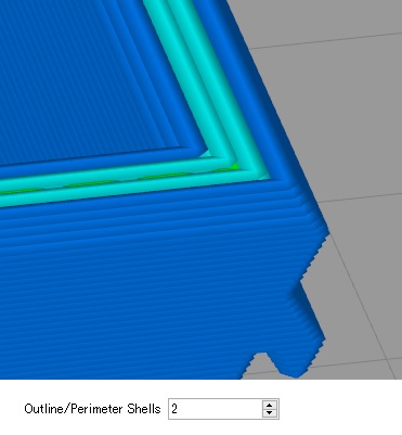

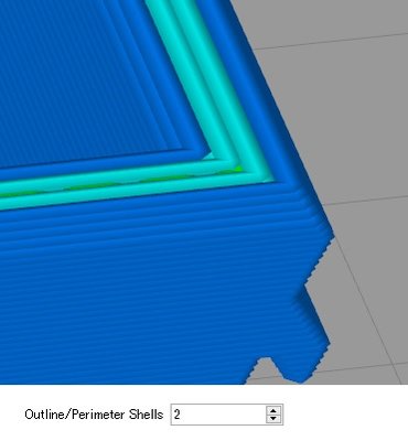

Do you want printing like the one below?

I apologize, I missed this, if the top surface and edges are at the same height, yes.
