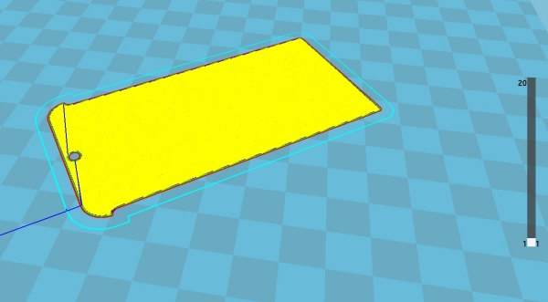

I only mentioned Stratasys to illustrate that the concept isn't new.
Cura has the feature also and it "appears" to do a good job in this case. Here is the first layer after using the lay flat option:
I've never actually printed anything with Cura yet but I track it's progress on their forum.
