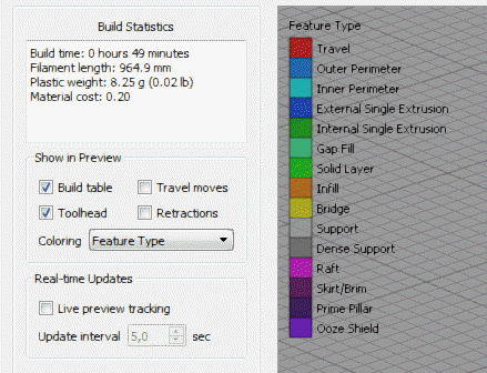

It will be shown in the preview
Support = light grey
Dense Support = dark grey
Perhaps you must scale down the preview with push-pull button in Layer Range to Show. It may be easier to have a look to it when Control Options is checked ON with only 1 layer (not Lines!).

Thanks,
I have been using this for a few years now.
It's not showing dense layers for me. Not on the bottom layers.
