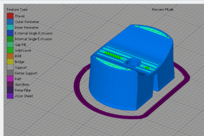

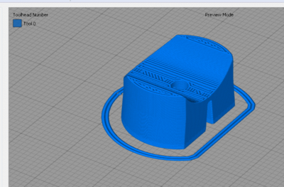

Do you have set the Right Extruder as Aktive Extruder in menue Additionals > Skirt_Brim?
Example, but my left extruder (!) for an object with 1 Layer and 2 outlines skirt with 2 mm distance
Otherwise please show the gcode of a small model as attached file.
H.
Print preview Feature Typ
Print preview Active Toolhead
