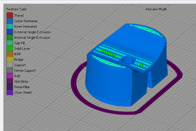

Yep, it works! thanks. I only now don't get any before print purge for some reason. I set it to run a single line around the print to purge out.

Do you have set the Right Extruder as Aktive Extruder in menue Additionals > Skirt_Brim?
Example, but my left extruder (!) for an object with 1 Layer and 2 outlines skirt with 2 mm distance
Otherwise please show the gcode of a small model as attached file.
