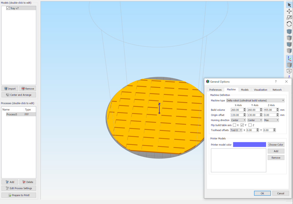

Is this normal? My delta (Anytcubic Predator) can print a 370mm diamter circle but only a 260x260mm square. Ok, fine.
In Simplify3D, I set it for delta and 370mm. I then dropped in a 370mm part, and it only filled a small fraction of the build plate. I had to change Simplify to a 260mm build area to show the 370mm.
That doesn't seem like how it should work.
See enclosed images - the part is 360mm diameter:

This is a bug report now.
While it was intentional for them to make the setup be from the size of the max inscribed rectangle, if a part is larger that that, but smaller than the max circle of the delta, S3D will say that the part is too large to auto place.
Re: is Delta size setup working correctly?
Thanks for your report of this issue. I've documented it for our development team to test and evaluate.
