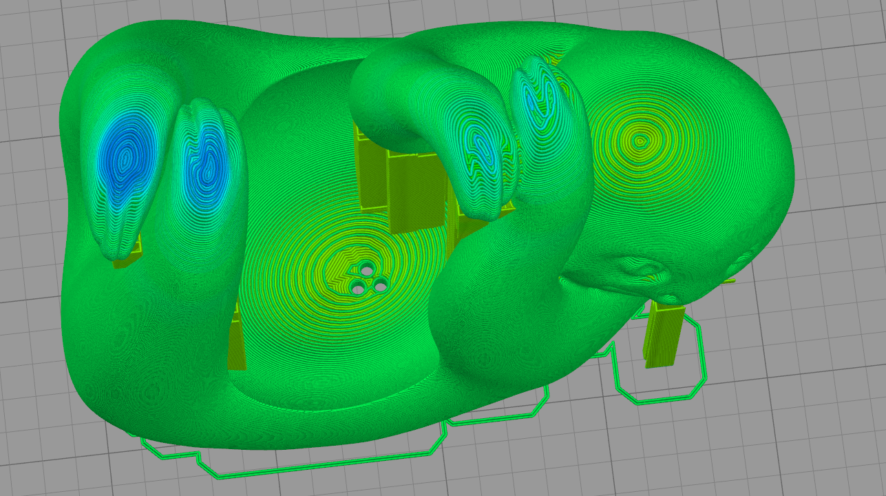

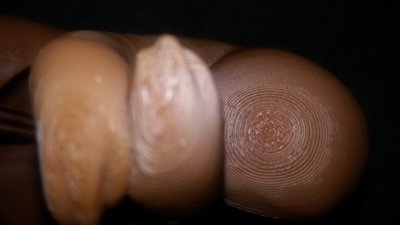

Hello,
Would anyone know how to solve this problems of the final layers not joining? I've already tried to raise the top layers, increase the fill, change the fill, outside-in, basically nothing solves, with the Cura these top layers look perfect, but the overall quality is not the same. Any suggestions of what I can do, and if it's something in stl how do I get it? The same occurs inside, but inside does not bother me. Thank you very much.

Guessing here... Are you speaking of the circles?
If so, that's a function of your layer height. You would need to reduce the layer height for that to smooth out. Maybe Cura is going dynamic there? I don't use it, so don't know if that is even possible. ;)
