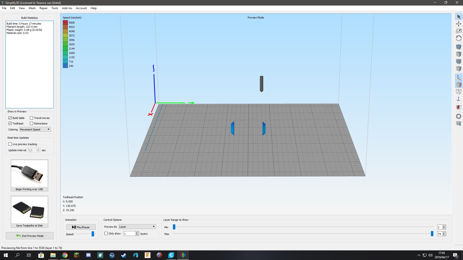

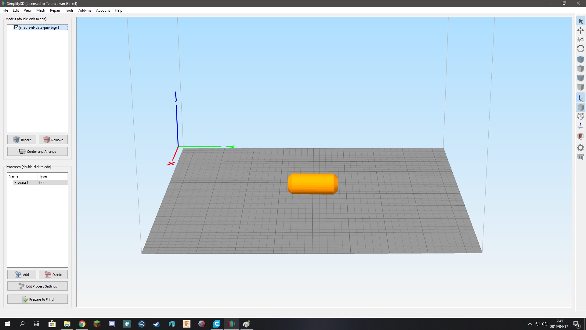

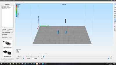

Not Slicing correct
Why would it be doing this???
S3D-Alex
Posts: 456
Re: Not Slicing correct
Could you post a Factory File showing this issue? Without any information it is hard to make a guess but my immediate thought is that this model has some non-manifold edges where the cylinder shape intersects the hemispherical caps.
I think this is simply the fact that the stl file has multiple meshes....and S3D is incapable of handling multiple meshes correctly.
The solution...if this is the issue....is simply to use the Separate Connected Surfaces option on the Mesh dropdown menu.
