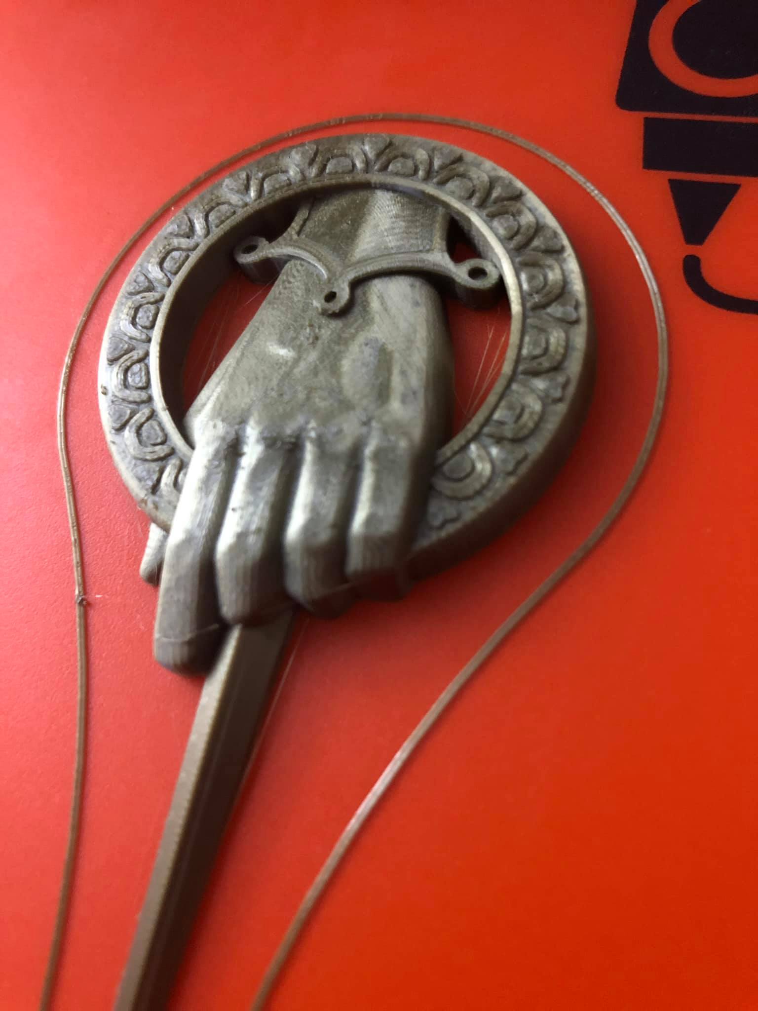

The blobs happen after the line. For some reason the nozzle pauses too long after and when it goes to the next line. Coasting doesnt do anything. I use more retraction 7-9mm but that was before I calibrated my extrusion settings. I havent used simplify3d lately. Or should I say S3D is better if you want to print something quickly and the supports are spectacular. If I want to get a perfect print I have to use Cura. I have been able to get s3d to make the blobs much smaller but I was printing .1 layer height.

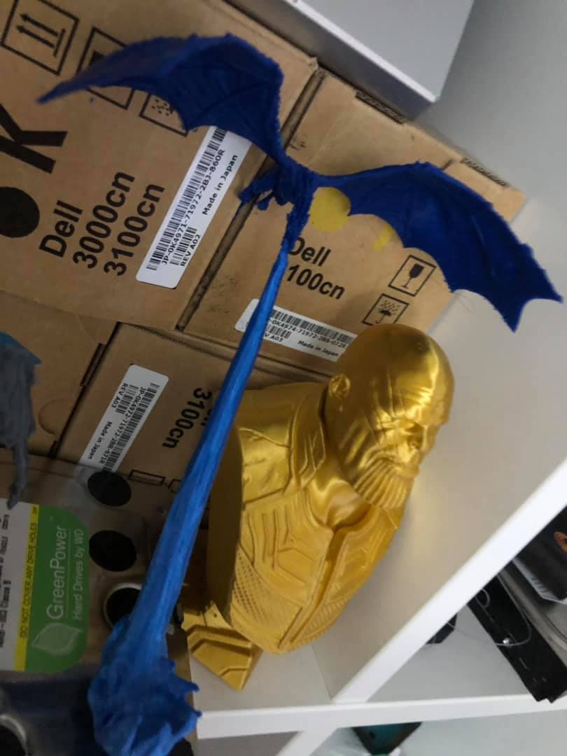

Here are some test prints. That is a hard drive under them for size reference. (The dragon and the girl are old/test prints.)
