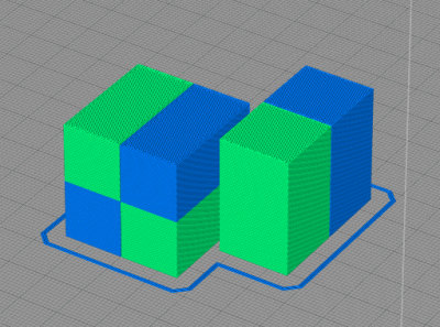

I'm trying to use dual color with S3d, but I can't get it to work. I've done dual color wizard and it's working fine. I'm using dual extruder with single nozzle and the distance to retract is 90mm (I'm using an 'Y').
The print starts fine and after first color, the extruder 1 retracts, then extruder2 extrude 89mm (i'm using -1mm as 'Toolchange extra restart distance') and start secon color.....this is working fine and no problem at all....the problem is when printer try to go back to color 1 (extruder 1) again! The second extruder doesn't retract-back 90mm and the first extruder starts extruding, jamming both filaments in 'Y'. In the GCode I can see the retract code for both extruders and looks fine......but it doesn't work!
What am I doing wrong?
My printer is a custom CoreXY running smoothieware. I've setup both extruders in firmware and I can see/extrude/retract both extruders using Octoprint without any problem. (T0 and T1).

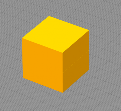

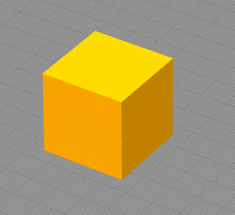

Opening your factory file it shows a cube. Ok.
Prepare to Print shows additionally the activated Prime Pillar. Ok.

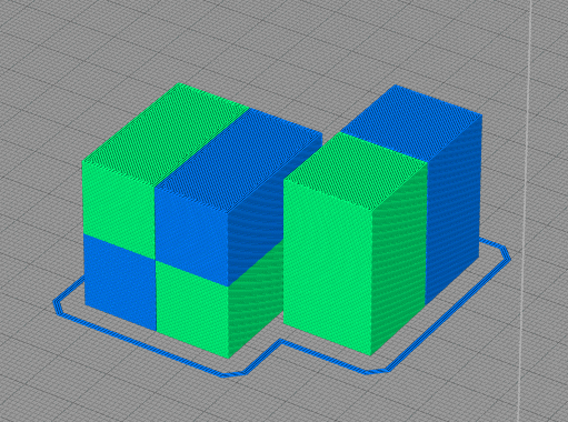

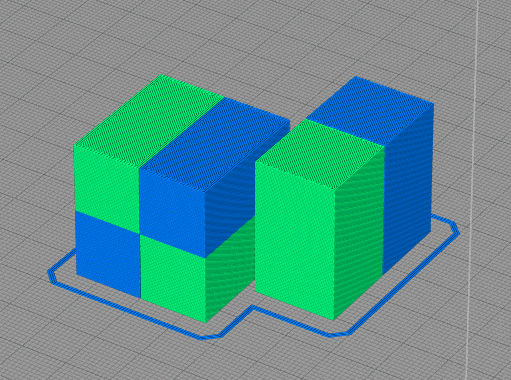

This code is fine, this is the retract for fillament change. I can't get even the prime pillar in dual color in my S3d :/ it shows only one color (cube shows two color fine).
Posts: 861
Re: Dual Color - Doesn't retract
jmaurin wrote: Mon May 20, 2019 6:36 am
... I can't get even the prime pillar in dual color in my S3d :/ it shows only one color (cube shows two color fine).
??? I only have open your factory file without changing anything and it shows in the Print Preview the Prime Pillar as 2-colored.
But I would expect to see this as only one tower, printed as bands alternating color1 and color2.
H.
