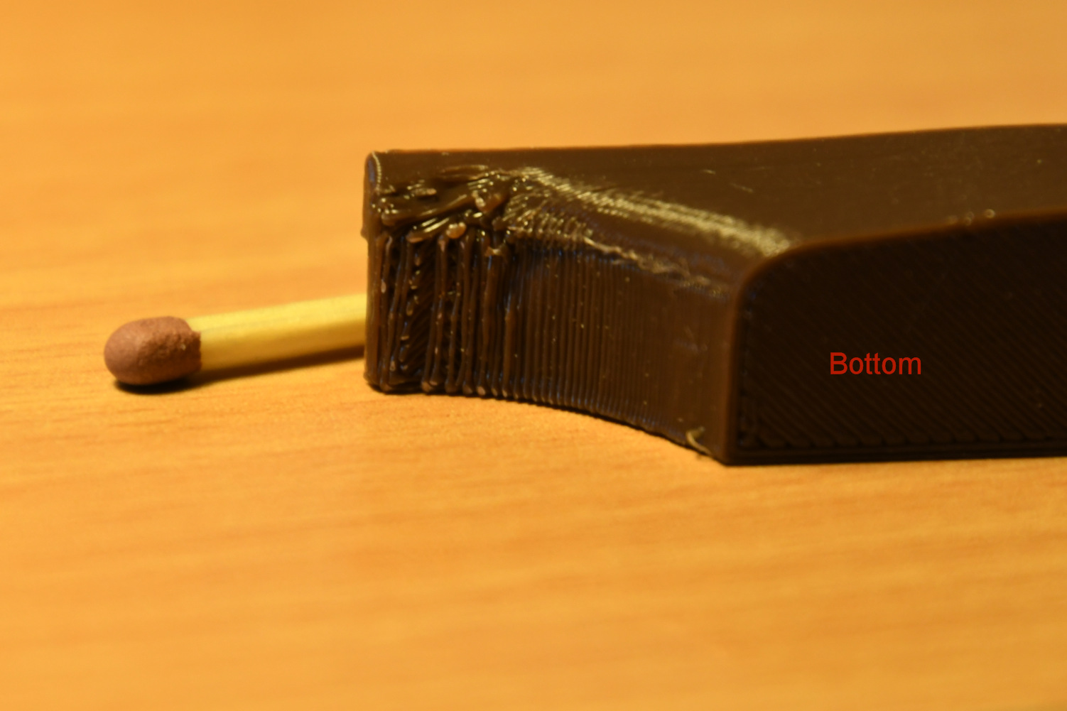

As can be seen on the picture, the lower site of this curved model is horrible as is the filleted edge at the same level.
I tried many different settings without succes.
The test model here is part of a bigger model. That's why it is oriented as is.)
I very much appreciate any help.

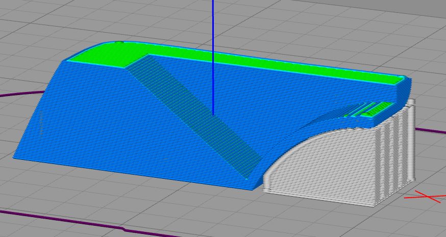

Attached: picture, pre-view, settings, and factory-file
Test support.factory
(694.4 KiB) Downloaded 137 times

nfol wrote: ↑Wed May 22, 2019 10:53 am As can be seen on the picture, the lower site of this curved model is horrible as is the filleted edge at the same level.
Best regards,
Niels
Set "Desne Supports" to 3-4 layers and 100%.
On Angle I use 45, -45 or 0, 90
Also check your speed, temps and cooling as this area will over heat easily.

Regarding dense support you write:
I am not sure what you mean with those *pairs* of figures?
My dense support is printet pependicular to the printing of the shell. Is that not supposed to be OK?

nfol wrote: ↑Thu May 23, 2019 1:38 pm Thank you for your reply.
I tried to decrease the temperature from 195 to 190 and to 185.
No change.
Then I added 4 layers dense support 100%.
No significant change.
At temp 200 and printing two objects, the result was a bit better (at the filleted edge), but still not good enough.
So now you can see that temp is playing a part. By printing two you have increased the amount of time between layers for each part.
So, you could also reduce the temp a bit if it still extrudes ok overall.
You can rotate the parts so that the overhang area points more to the outlet for the cooling fan.
You can also go to the first tab and at the lower left select the print island sequentially or whatever it is there. This will make it print one layer then move to the next area rather than doing a layer then the next before moving. Sometimes this can also help smaller areas cool a bit more.
What I meant with the angles is the support angle section to the right of dense supports.
Doing something like a
45
-45
will make the support structure do alternating 45 degree angles and make a much stronger support structure.
