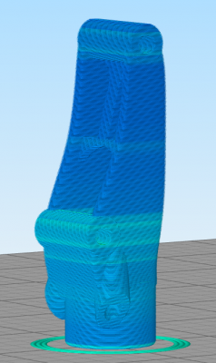

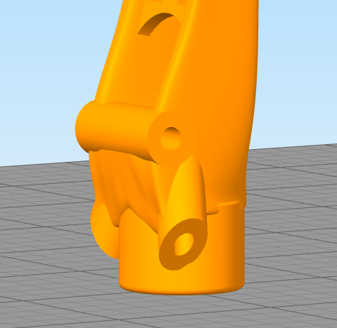

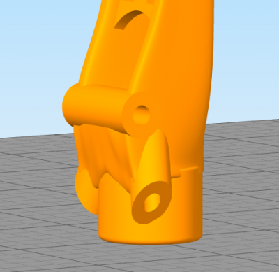

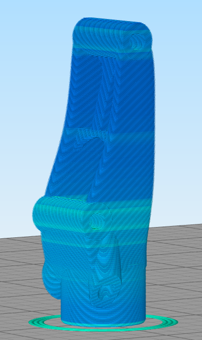

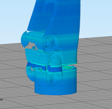

I'm trying to print the attached files. When I slice the .stl, I get a file that has a lot of gaps that the original doesn't have. I'd upload the factory file but it's 6mb...
What's going on? Cura slices this with no issue.

I take that back. It "fixes" it, but unfortunately the model becomes completely solid, which does not work. =/
Still open for suggestions.
