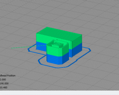

I attache the gcode, comming from your factory. You can compare it with yours origin.
You can also import it in your installation (menu FILE, Preview G-Code file) and for testing you can import it as FFF (! - obtain extension .fff)
H.
Dual.gcode
(539.74 KiB) Downloaded 165 times
