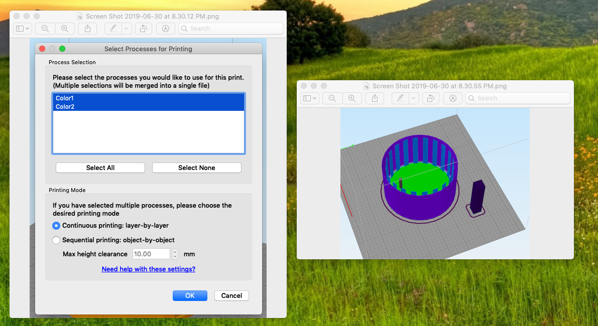

I am using the stock Ultimaker 3 configuration, with modifications to the Tool 1 temperature and print speed because of the material I am using. I import the 5 models and I see this:

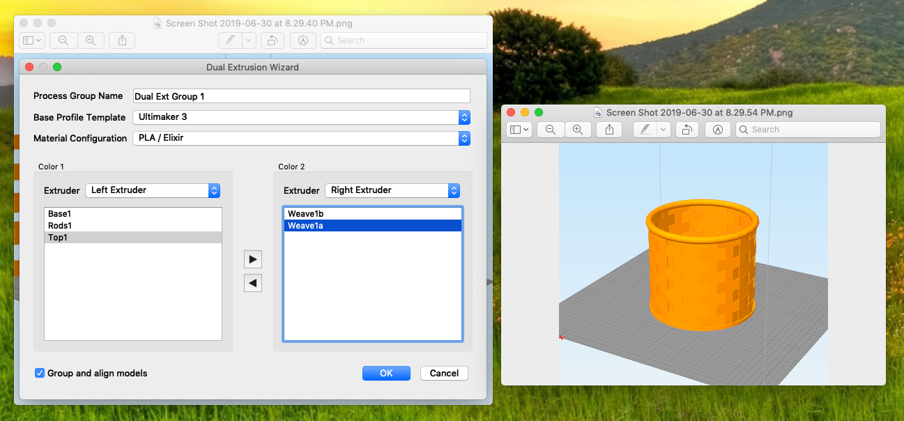

I then use the dual extrusion wizard and it groups everything up perfectly:

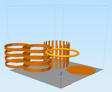

However, when I slice the models and view the layer preview, the horizontal pieces do not show up:
I thought maybe it was an issue with the machine setup, but if I swap the models between Tool 0 and Tool 1 I get the same result.
Any ideas why the two horizontal models are not printing? The only thing that seems odd about them is that they are not in contact with the bed; they rely on the models being printed by the other tool to act as supports. However, that seems like a common scenario if you were using PVA as one of the materials, so I am at a loss. Any help would be very appreciated!

There is a lot going on here so it would be really helpful to have a Factory File to look through. Can you please post one showing this issue when you have a chance?

Here you go! If you slice it and look at the preview you will see that the horizontal pieces do not appear.

A very simple thing...….
In the Color2 process, set the ExternalThin Wall Behavior to "Allow single extrusion walls"

THANK YOU!!! That did it!
