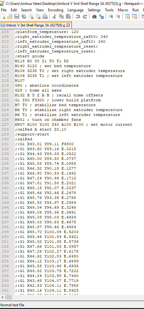

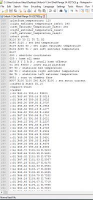

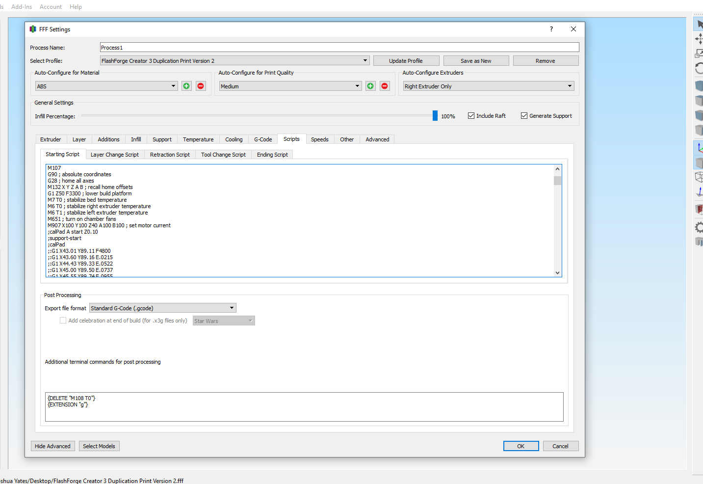

JoshuaYates
Posts: 31
Joined: Wed Jul 08, 2015 10:17 am
Re: Flashforge Creator3
If you use the profile I have supplied "Version 2" check to make sure the start script inlcudes the gcode you can see in the image.
Also make sure the additional terminal commands looks the same as the image.
You can then open up your generated g code to ensure the calpad has been added into the file.
If you have issues, if you can create a file with a random object, send me over the gcode file and I can see if something is missing.
