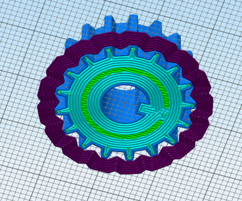

it pulls the skirt down under the zero-level. Perhaps it is the last call to have attention to a very unusual situation.
I'm printing any time with negative Z-Offset, -0,12 mm when the layer height is 0,20 (in sum positive)
But it seems that the program doesn't understand why you want to print under the table. Me too.
GER
Have a look under my table ...
