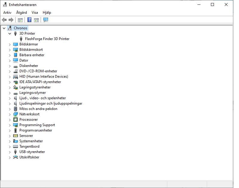

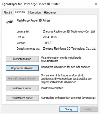

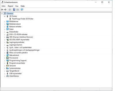

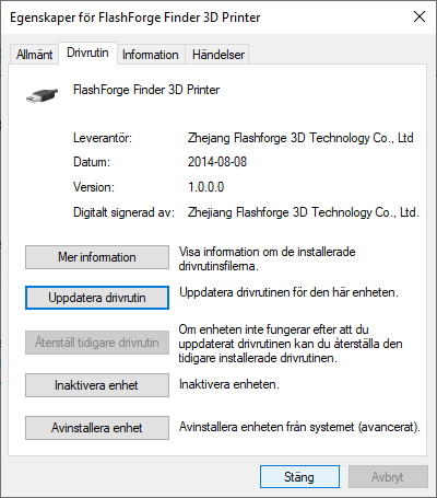

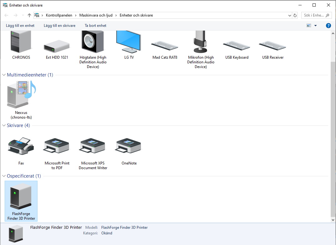

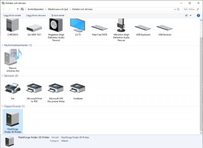

I can see the printer in Win 10 device manager. But it is NOT listed as a com port, but rather as a 3d-printer. If I use Flasprint slicer, it has no problem finding the printer with USB or WiFi, so I'm pretty sure the drivers are working as they should. But as the printer isn't listed as a port in Win 10, it doesn't show up in the port drop-down in S3D. My Win 10 is in Swedish unfortunately, but I attached some picture for you.

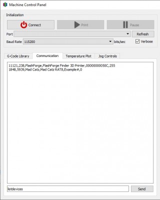

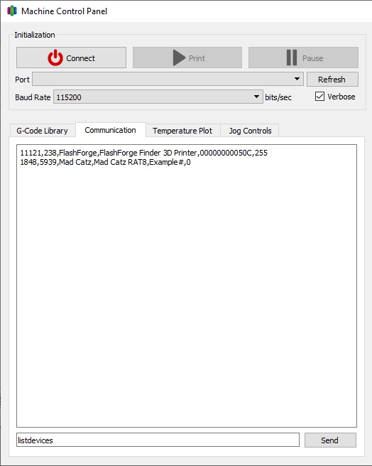

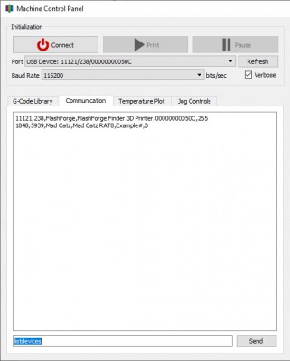

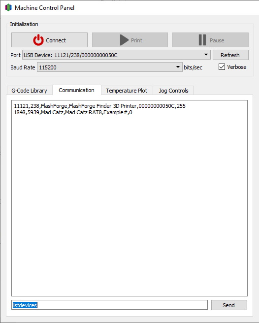

Are you currently using the most recent version(4.1.2) of Simplify3D? The printer will identify as a USB Device but should still populate in the Ports drop-down found in the Machine Control Panel. If there are still no options populating in this drop-down then please type listdevices into the prompt in the Machine Control Panel and hit enter. This will return information about any USB devices detected by Simplify3D.

When I send the listdevices command, at first the dropdown is indeed populated with the printer. But after a couple of seconds, it disappear, and doesn't show up again until I issue listdevices command again. I have tried switching the usb-port on the computer but I still get the same result.

I found if you type "listdevices" the USB device for the printer shows up.
If you immediately click [Connect], it will connect and work properly after that.
