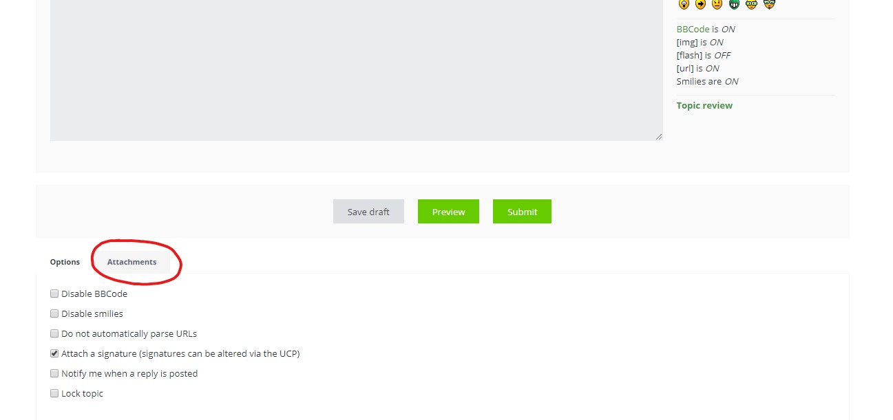

We would absolutely love to take a further look at this. Could you post the OBJ or ideally the Factory File from Simplify3D with the OBJ present? You can attach files by clicking the 'Attachments' tab or by dragging and dropping them into the message box. I included a screenshot of the Attachments tab as it is tough to describe where it is.
