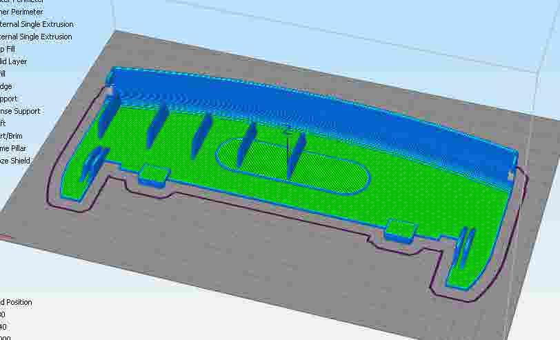

I have inherited a Flash Forge Creator Pro and am having a few issues I hope the community can help me with.
I have created models before and not had this particular problem.
I am using ABS and running the latest S3D software 4.1.2, layer height is 0.2mm, nozzle diameter is 0.4mm.
I have a model that has two areas slightly lower than the main body. This is causing the main body to be above the bed by 0.2mm.
Because of this, the system is creating a bridge (yellow layer) as the second layer, but the area is far too large with nothing to attach too.
So when the second layer starts, it is too far above the bed and is not sticking to it.
Rafts and brims are segregated islands for the rear support structure and the two front areas that are lower than the main body and so if used make the problem worse.
I have attached the factory file and believe this is all that would be necessary, but correct me if I am wrong.
Any help, grately appreciated.
