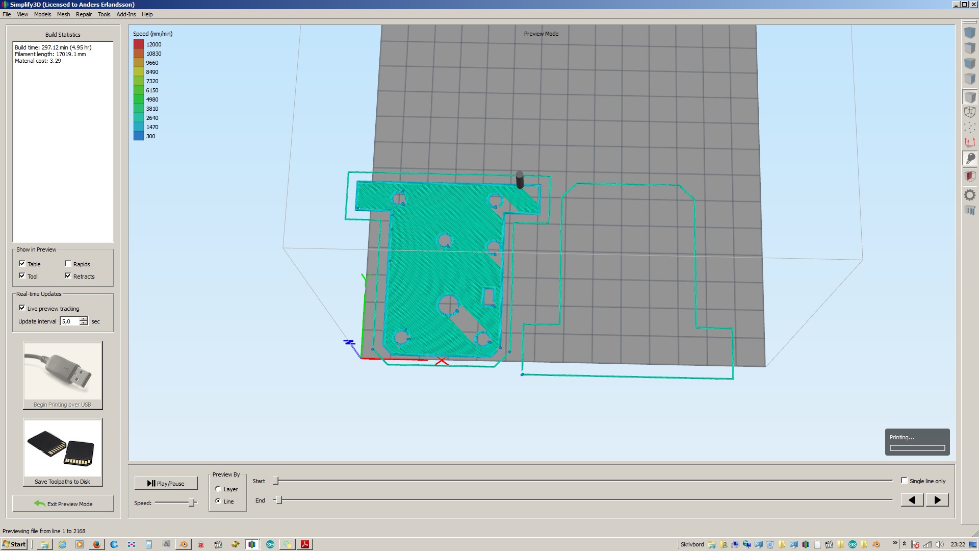

I have had problems ever since i started using s3d with the build placement.
If i place an object in the middle of the view, it prints a couple of cm to the left and out. If i place an object far to the right in the view, the printer hits the end.
If i place an object a bit outside the buildview to the left i MAYBE can find the leftmost position.
attached picture show what i mean. even this placement hits end on the right and there are about 3cm left on the front, 1 cm on the left.
I THINK it has something to do with that the buildplate only show 16 squares (cm). My machinesettings is set to 200mm on all axis.
I am not using "update machinesettings" in process editor, as i only have one printer.
Repetier is showing and printing correct.
Printing on a K8200.
Using autobedlevelling with servo, and it measures correctly. An if i move bed manually it moves to correct position always. My home is front left corner, which is spot on.
Has nothing to do with the bedlevelling firmware changes as i have had it since the beginning.
