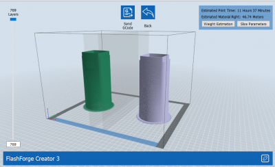

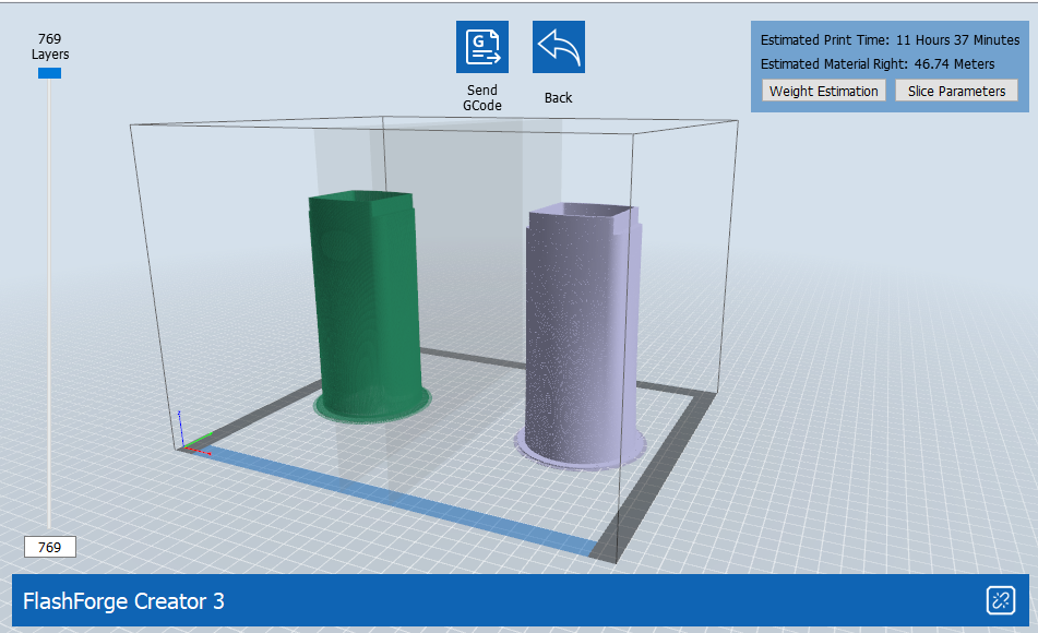

Image 1 shows the model sliced inside S3D.
Image 2 shows the gcode viewed by flashprint.

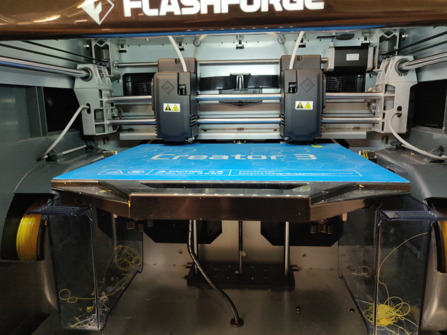

Image 3 shows the calibration pad being made.

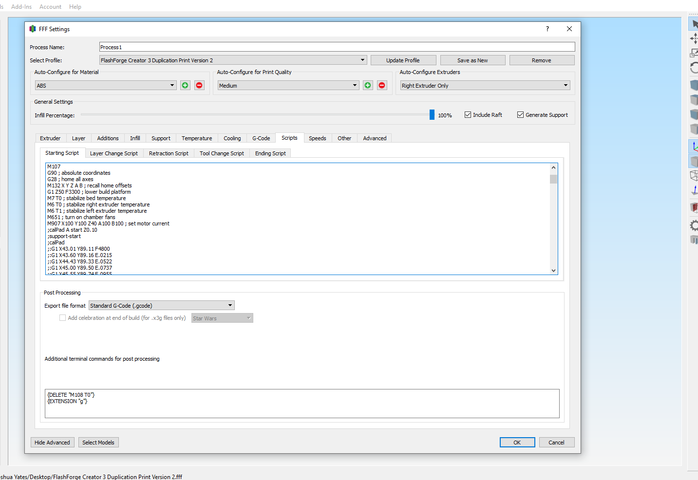

JoshuaYates
Posts: 31
Joined: Wed Jul 08, 2015 10:17 am
Re: Flashforge Creator3
Image 4 shows both nozzles getting into position.
Image 5 shows the model being printed correctly with both nozzles having half the build plate each.
Image 6 shows what you should be able to see in the starting script and additional commands.

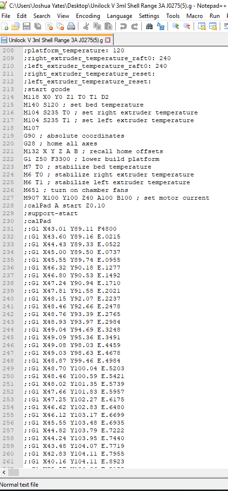

Image 7 shows the gcode file with the included calpad gcode included from the profile.
This is all done using the attached version 2 profile.
The software does not show the calpad being made. Not sure why although it does work fine.
If you use the profile and you are having results different from the images then please send over a gcode file and I will see if something is missing.

JoshuaYates
Posts: 31
I believe if you want mirror mode, change the D2 value to D1 at the end of the M118 line.
