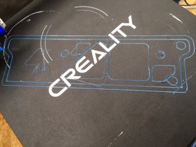

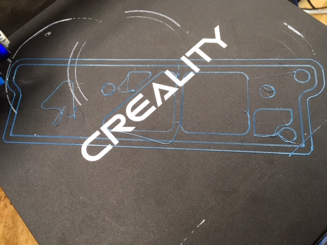

Skirt and perimeter sticks fine , then disaster
hey ,
i use Simplify3d with Marlin firmware V2.
The z-offset is perfect , my skirt and perimeter sticks Fine but when i go start inside the first layer then it won't stick anymore.
Bed Leveling with BLtouch probe and G29 command before each print
first layer height : 130% , width 150% speed 30%
See picture for problem
Someone a idea ??
airscapes
Posts: 403
Re: Skirt and perimeter sticks fine , then disaster
just for fun set first layer height : 100% , width 100% speed 30% and see if that helps
DzzD
Posts: 16
Joined: Thu Oct 24, 2019 4:16 pm
Try to reduce fan, or even do a test with fan disabled.
