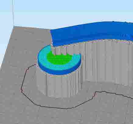

S3D-Alex
Posts: 456
Re: How toStrengthen Tall Thin Supports
Since you only need it for this one section it may be best to manually place a couple large pillars beneath the hand here. Do the Auto-Generate at 1mm for accuracy but then manually place a 5 or 6mm pillar or two under the fingers to give those supports a nice big area to build in.

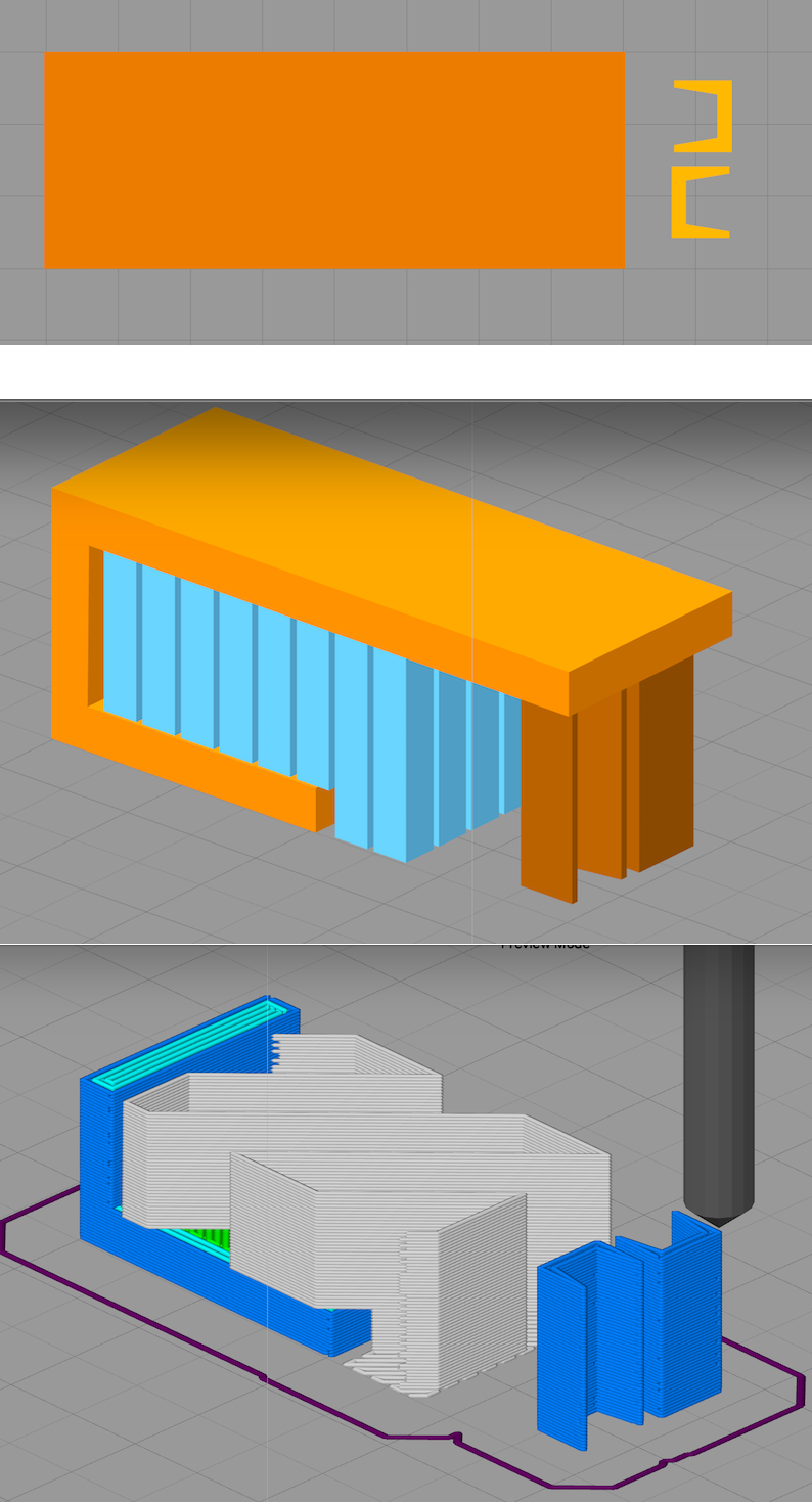

greybeard
Posts: 178

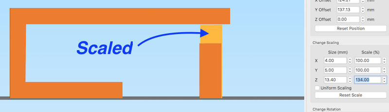

As previously mentioned, you can add a Support Part...
Example shows placement of two Support Parts:
• one rotated 180º about it’s Z-axis
• both were placed under overhang and use the Scaling feature (showing one scaled Z, non-uniform)
Attached is the Support Part. You can scale that too as needed (current dimensions may be heavier-duty than you want...)
For the example, I added some supports manually...
Support1.stl
(1.45 KiB) Downloaded 387 times
