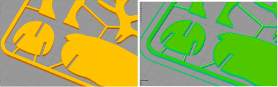

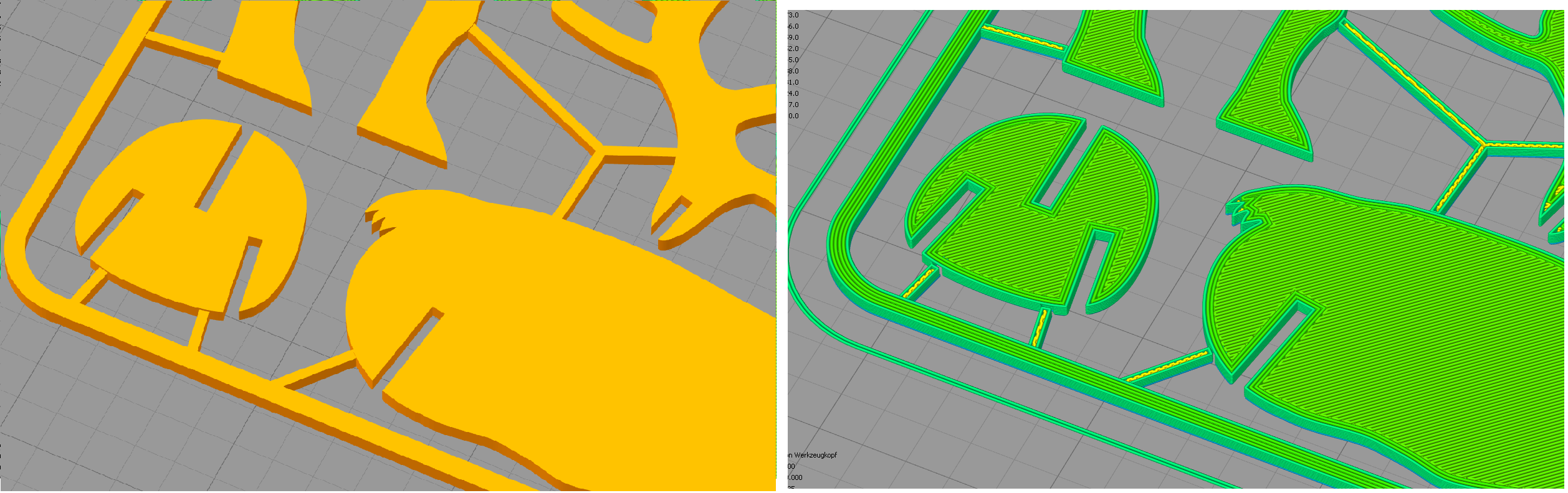

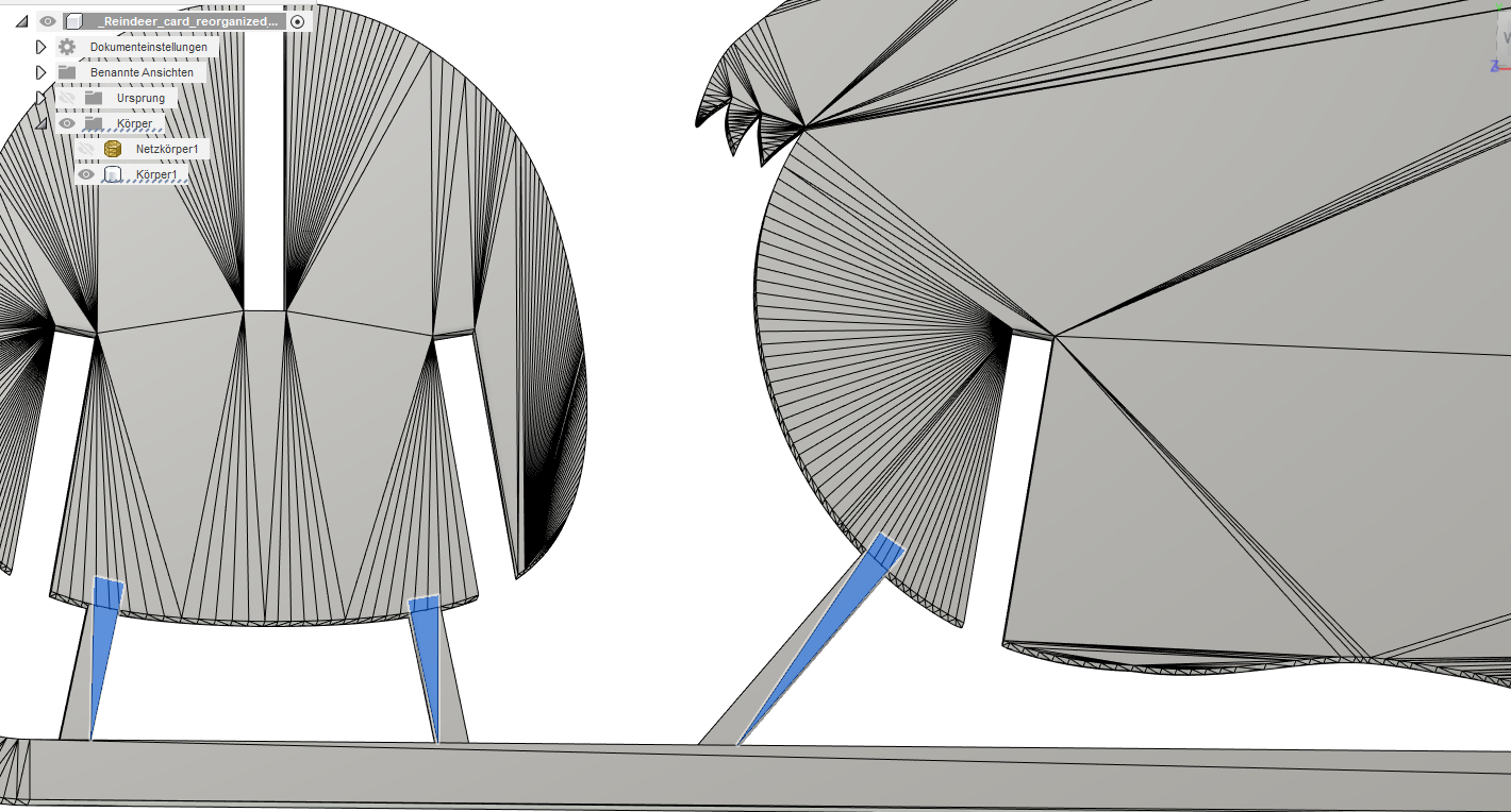

theres a gap in the 3D-print part, even though the file doesn't. I have even imported it in Fusion 360 and Siemens NX to check, but as you can see in the pictures the small bridges are going way in the specific parts. When i start to calculate the print (and print it) there are gaps.

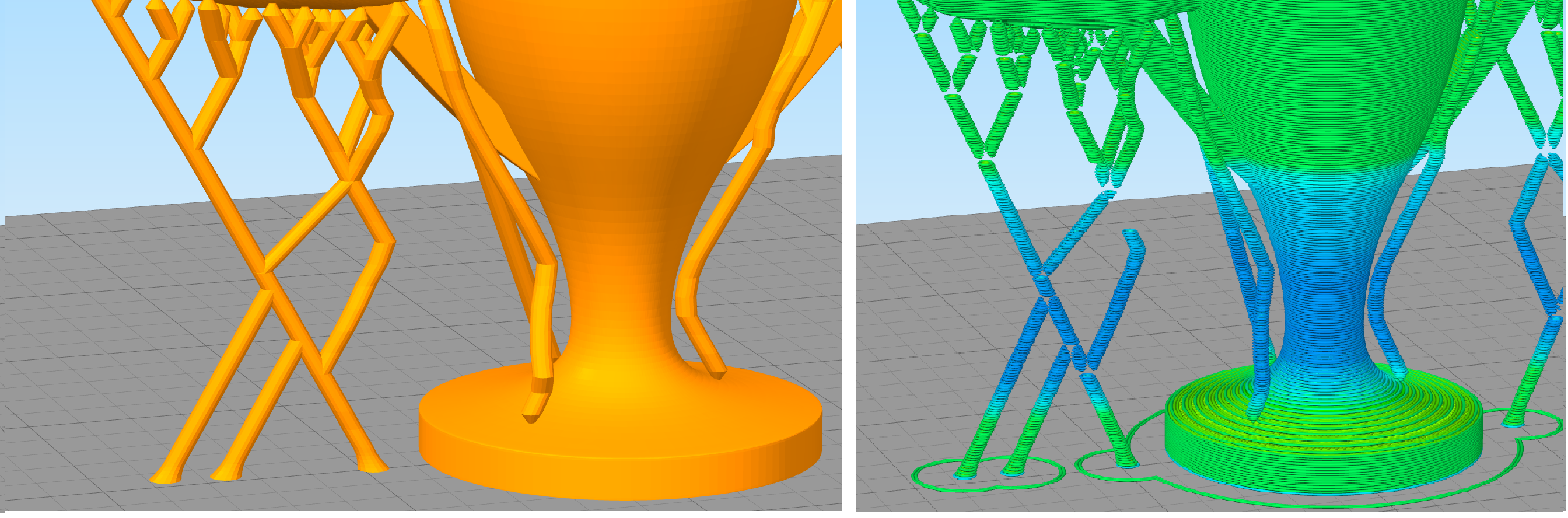

I had this issue a week ago too, with files, which already got support from thingyverse, there was the same problem.

Do a search on the forum for Separate Connected Surfaces. Your answer will be in what you find.
