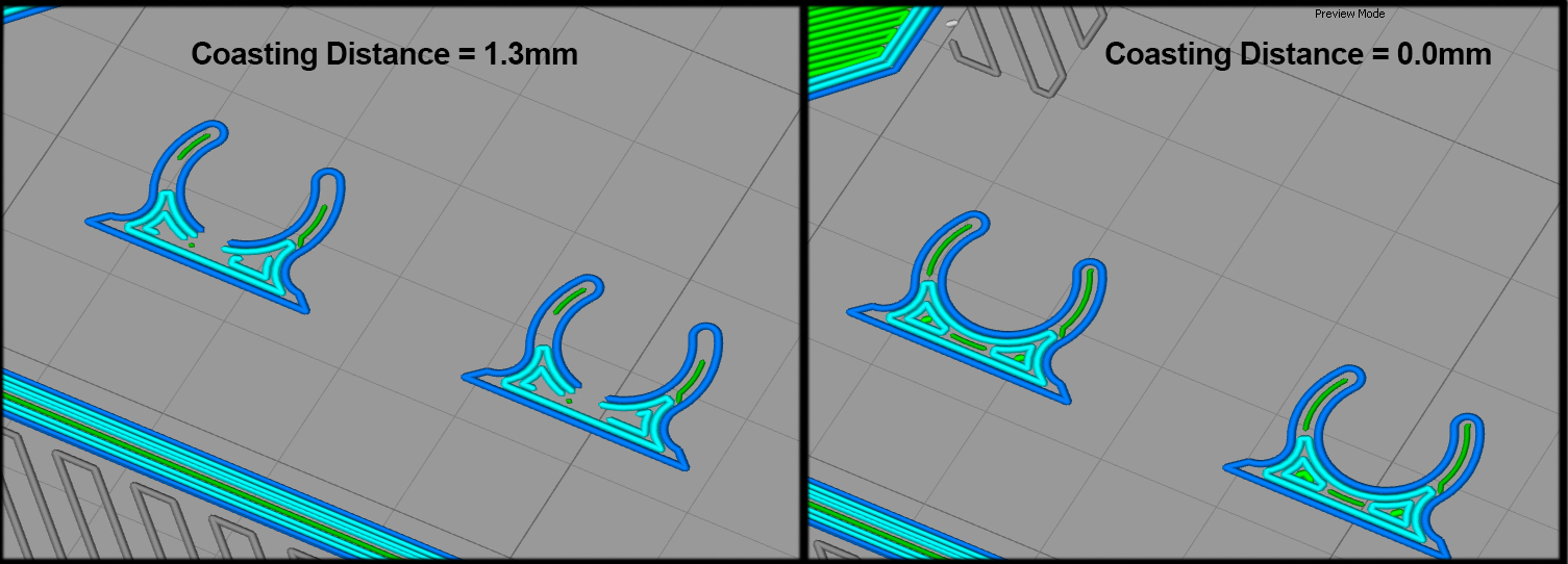

I'd like the option to set the coasting distance for the 1st layer to be different than everything after that. I'm finding on smaller parts the infill is pretty bad on the base layer because the coasting distance is effecting things.

Have you tried using the variable settings wizard to create another process just for your first layer? This would allow you to configure extruder settings for just the first layer from the extruder tab of that first layer process.
