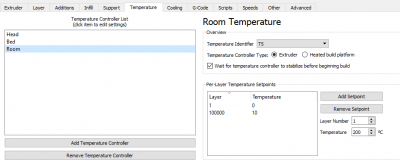

It seems that S3D cannot correctly handle the management of a room heater.
S3D currently has 2 kind of heaters : head and platform, nothing for the chamber.
Plus, only one bed heater is allowed in S3D. In consequence, I have to declare the room heater as a second head heater.
Here is what it looks like in the XML file of the file and I have attached a screenshot of the GUI.

You will notice that the room heater is declared as "T5", it is normal, it is the tool number of this heater in the firmware of the printer.
The example I took is for PLA, so a material which does not require an heated room but you may also notice that there is two temperatures set up for the room :
Code: Select all
layer 1 : 0
layer 100000 : 10
And this is where I think S3D does not handle correctly this temperature controller.
I have multiple material set up in my S3D configuration. Some of them -like PLA- do not need an heated room and some of them -like ABS- require the heated room.
If I just put "layer 1 : 0" for PLA and "layer 1 : 90" for ABS, S3D will only takes the "layer 1 : 0" into account and thus deactivate the room heating for all materials, including the ones where I previously set up layer 1 : 90.
In other words, I have to include a positive value for this heater for every material. But I still do not want to heat the room for materials like PLA so I had to declare a positive value at some unreachable layer.
My workaround is working but it is a workaround, not an elegant solution.
