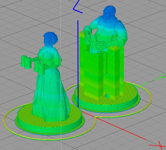

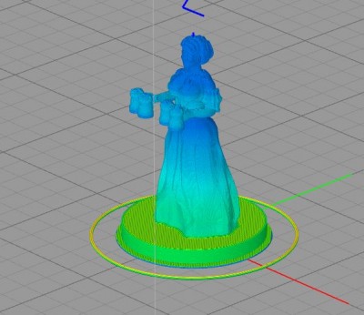

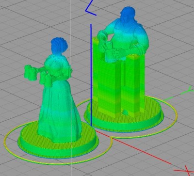

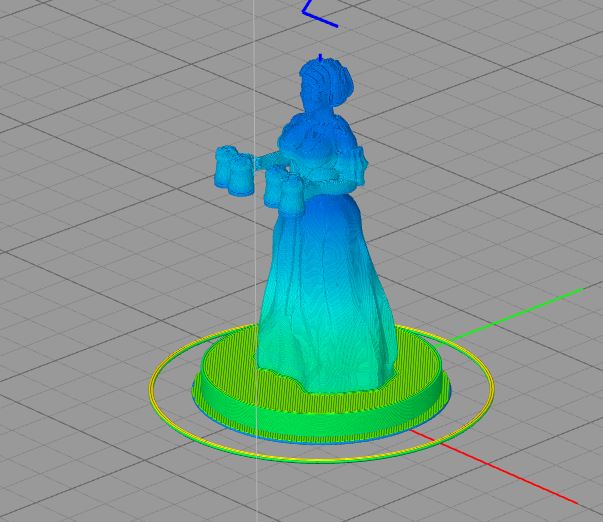

EDIT: I am also having issues with supports. I can't seem to get them to generate on some models, but have no problems with others. I attached a couple images below if you don't quite get what I mean. I'm not sure if it makes a difference, the Factory file that is attached was generated with a model ready to print that is having problems with supports.
Thank you for the help, it is greatly appreciated.
