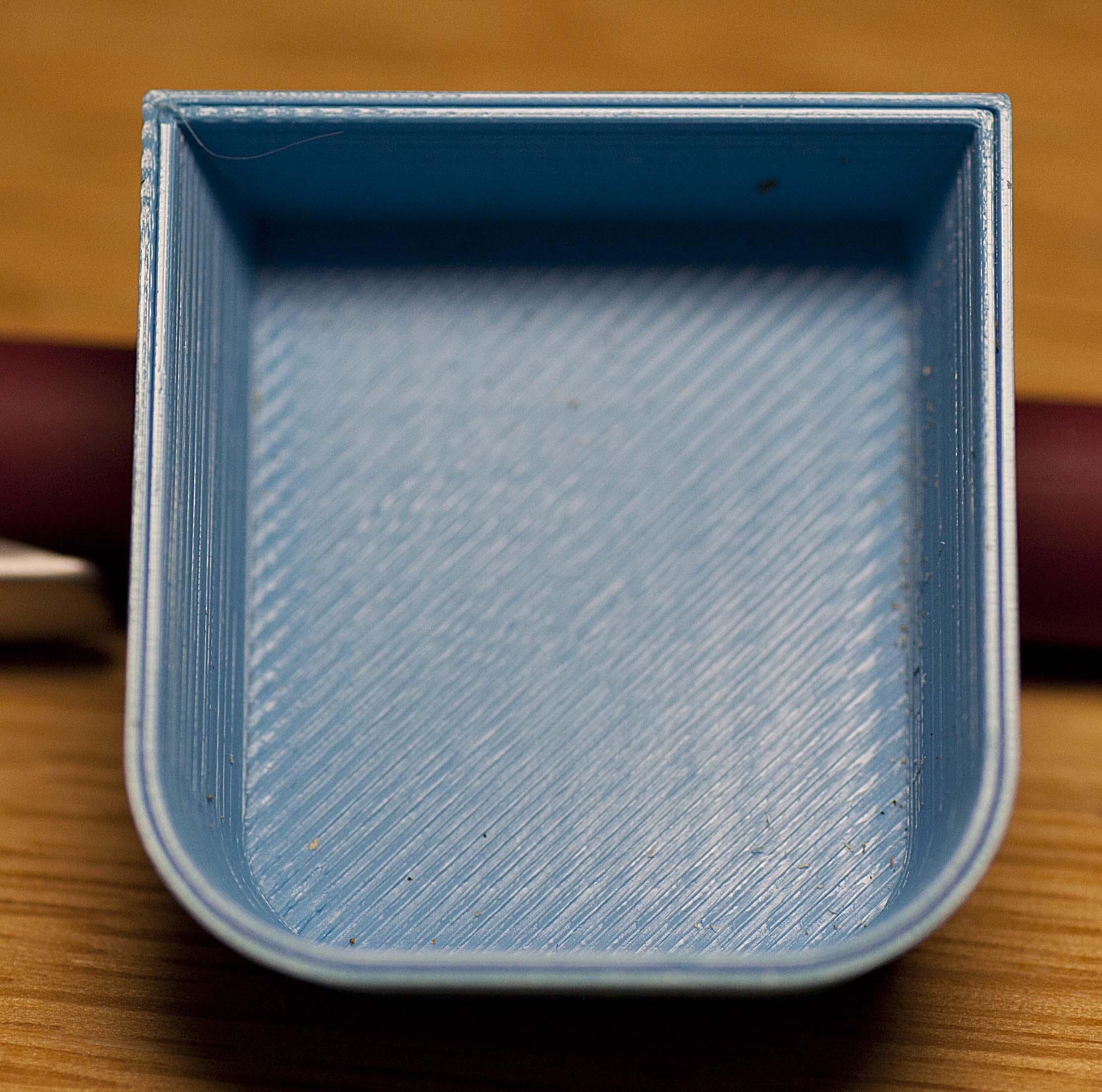

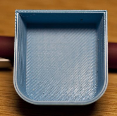

I'm using Ultimaker 2 and I have faced a problem with Simplified 3D when I try to make thin walls. Regardless the different settings I have used, a wall of 1 mm becomes 2 walls with a space in the middle. The space is visible at the final part. No cover at the top layers.
Attached: Pic of the part and settings.
Grateful for any idea how to overcome the problem.

This is a common problem and is caused by having a wall that is thinner than 3X perimeter width. Walls thinner than 3X the width of the extruded filament cannot be printed the correct size unless they are an exact multiple of the extrusion width. If you think about it you will see why - if my wall is (say) 1.2mm thick and my extrusion width is 0.5mm, the two perimeters will take up 1.0mm leaving a gap of 0.2mm which is too narrow to fill with a 0.5mm extrusion. Any thickness above 1.5mm can be made with 2 perimeters and an infill pattern and so don't need to be an exact multiple. To fix the issue, either change the design so that the wall is a multiple of your extrusion width, or manually set the extrusion width to be an exact factor of the wall thickness (but don't make it much greater than your nozzle diameter).

I have tried following your advices and sometimes it works. Anyhow I feel the software instable in situations like this. If I'm using the program enclosed with my machine (Cura), it works without any problem. It’s a pity because Simplified 3D has a lot of useful facilities that are missing in Cura.

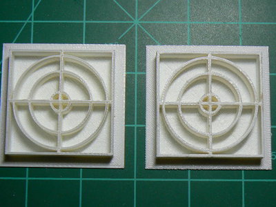

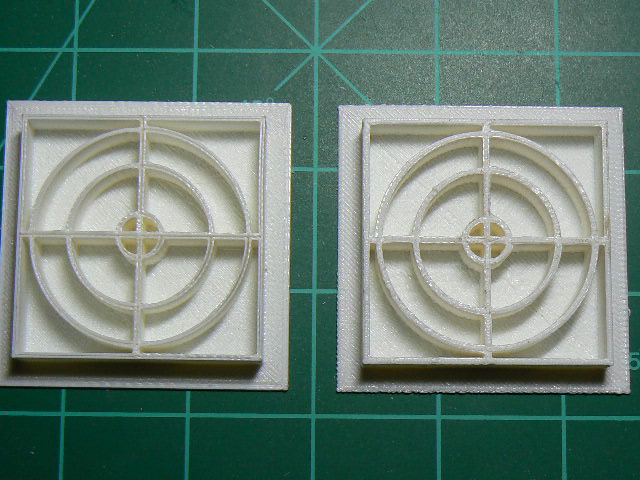

Consider the parts in the attached photo. This object was specifically designed with 1mm thick walls to test the ability to print them solid. These are two prints of the same object on my Makerbot 2X using the MB slicer. The one on the left was printed with three perimeters. The printer, per the slicer, made a single perimeter pass on the outside walls of the object. Because the gap between the two perimeter passes is less than the width of the extruded fiber (as configured in the slicer settings), there was not enough space for a full width pass and the slicer left the gap unfiled. The print on the right was printed with a single perimeter and 100% infill. In this print, the printer made the same single perimeter pass on the outside walls of the object. Then the slicer commanded the printer to come back and fill in the gap resulting in a solid 1mm wide wall in the print. This shows quite clearly that there is no physical limitation of the printer's ability to fill in the gap in this kind of situation.
As I noted in my earlier post, Slic3r has a setting that can be used to fill in these gaps. In over a year of using Slic3r, I've yet to encounter a gap so thin Slic3r couldn't fill it in. I can print this same part on my Solidoodle 2 using Slic3r and the 1mm walls print solid regardless of the number of perimeters selected. Thus, I conclude that Simplify3D could also be enhanced with a function to fill gaps also: perhaps something like 'fill all gaps less than Xmm'.
