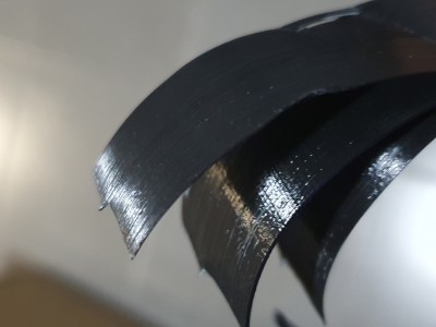

Trigger82
Posts: 8
Joined: Sat Jan 18, 2020 12:05 pm
Re: Outline Shells Not Bonding
Well your not the only one.
Had Simplify3d for 2 days now and can't get the same print quality I can on Cura ???
But heres a pic of my delamination
Ayres3D
Posts: 97
Joined: Mon Aug 14, 2017 1:15 pm
The normal reason for this is that the thickness of the wall that's being printed is not a multiple of the extrusion width. eg extrusion width is 0.4 and the wall is 1.0. That leaves a 0.2mm gap between two 0.4mm extrusions. If this is what's happening then the best option is to play with the wall options in the Advanced menu. Typically, set single-extrusion fill which will create a narrow single extrusion between the two "full" ones. You could also "force" it by upping the extrusion width, but this is a less elegant option.
Trigger82
Posts: 8
That was one of my first print with S3D, I ended up using that single extrusion infill. Didn't quite help. I also noticed I was getting a little under extrusion in other places. Then I noticed the default extrusion multiplier was set at 0.9, with a bit of fiddling its happy at 105% and no delamination, infill gaps etc. Just nice happy walls.
