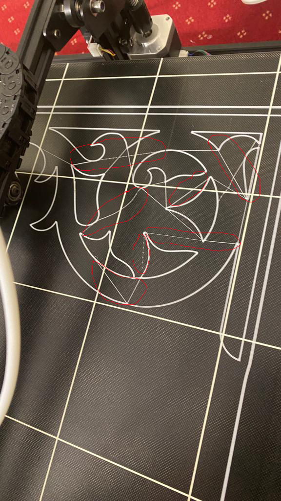

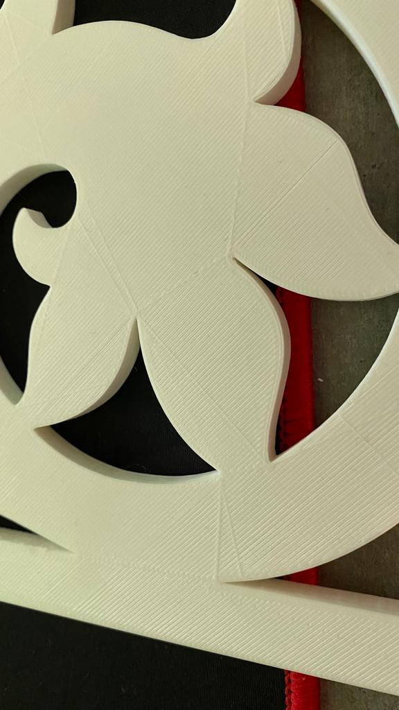

Hello. I have a problem with the prints or better said with some lines that appear in the print. The printer used is Anicubyc Chiron, the material used is PLA, the printing temperature is 210G, the bed is heated to 60G (I used the standard settings, because I have no idea what I should change) These lines remain until the end . In the first picture I circled in red the lines I'm talking about.
Any help is welcome. Thanks.

It looks like you might have Only Retract when Crossing Open Spaces turned on. Could you please post a Factory File so we can look into this a bit further?
