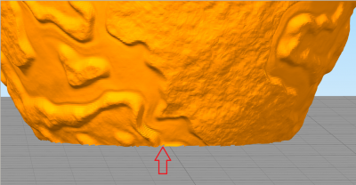

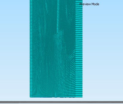

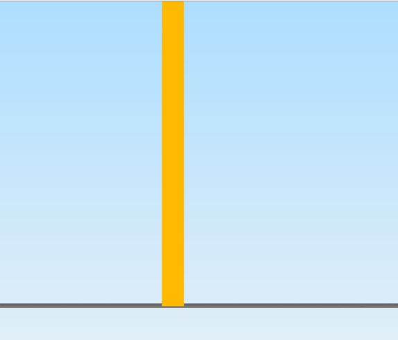

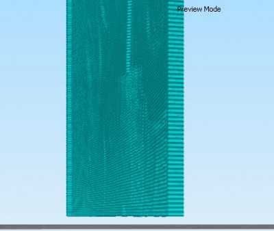

I have the same issue and found solution to avoid it: making flat bottom of the model done the trick.
Please look at attached images: raft is generating only at the flat part of model's bottom without notches.
