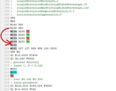

i need some advice on how i can change the order in wich the extruders work in a 2 component print.
Usually they work like this:
T0
T1
Layer Change
T1
T0
...and vice versa.
I, on the other hand, need it to begin printing every layer on the same extruder
T0
T1
Layer Change
T0
T1
Layer Change
...and so on.
Thanks in advance
EDIT: Found a solution:
If you split the print into 2 processes (1 per component) and make the first layer hight a bit bigger by a minimalistic amount on one of them, simplify will print this process as the second one in EVERY LAYER. Alternatively you could adjust the global g-code offset in one of the processes
