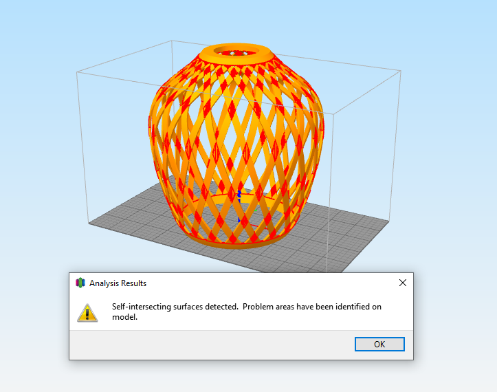

I was able to eventually get it to download. It looks as if the model has several identified areas where the model is intersecting its own triangles. This is generally not good for sliced results in Simplify3D. I'd suggest cleaning up the STL in Microsoft 3D Builder's automated repair functionality or remodel it in your CAD package and export a clean model.
Self Intersecting Check
Another common solution is to check if the model can be split into multiple bodies via Mesh > Separate Connected Surfaces.

It's ok, you gave me THE solution : Mesh > Separate Connected Surfaces.
